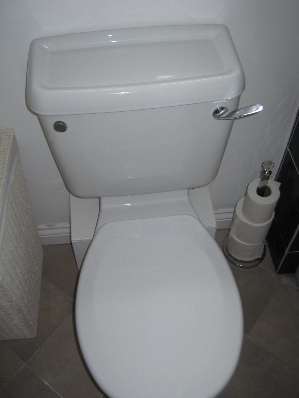

A photo might be informative. include one sideways-on to show the shape of the trap.
One like this can be worth a lot.

please let us have a photo
if it happens to be a Twyfords Syphonic it will fetch more than your new one costs.

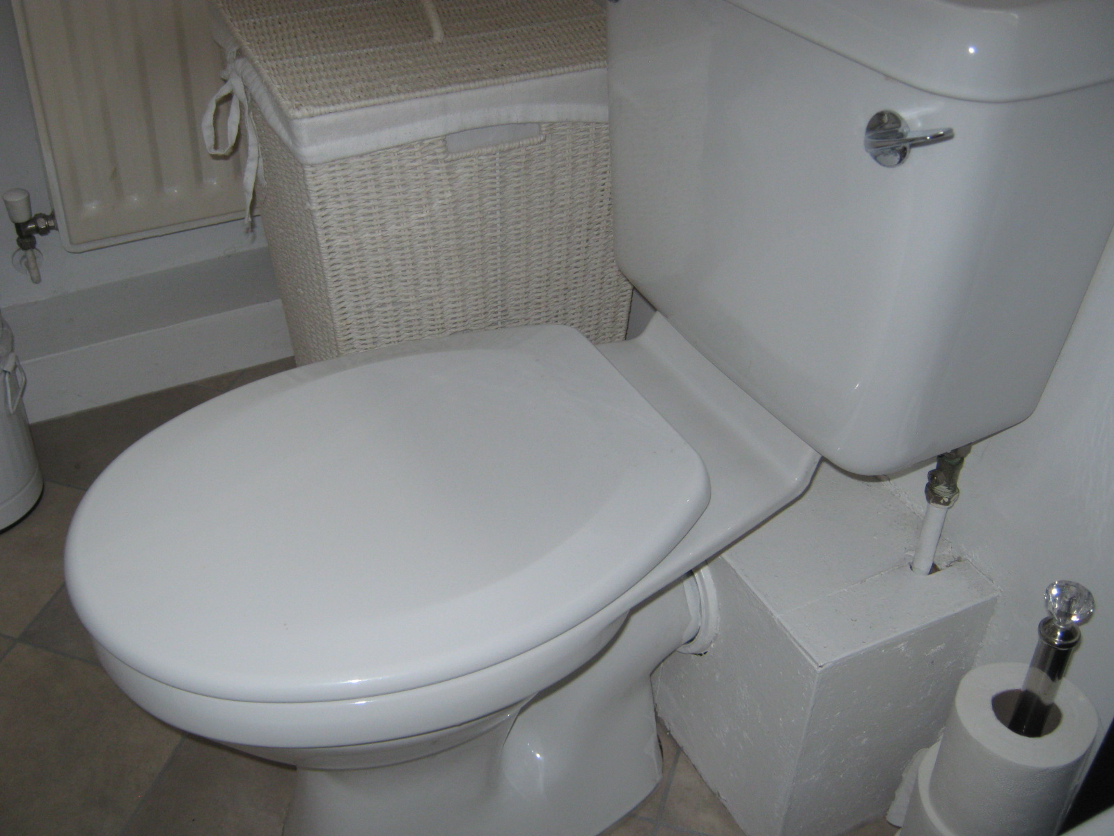

Never thought I would be posting pictures of my toilet pan on the internet but here goes.

I can't see the trap well enough to tell. Can anyone else?

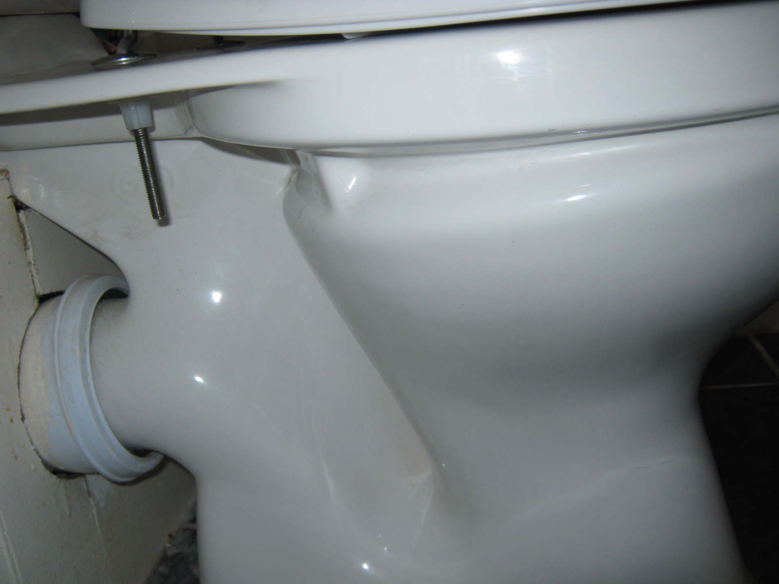

you really need to kneel down and photo the side
original cistern and lid look uncracked, and it's not aubergine or other unpopular colour.
From what I`m seeing it doesn`t look like a syphonic pan. Hate to say it but whenever I see a box of that size behind a pan I think "macerator" and the op mentioned a sucking noise? I`m guessing here but as the op said the pipes from basin & bath connect to the stack below the toilet I guess this is visable from outside?
This is the best I can get. If it is worth something I could be really in the money because we have exactly the same setup in the downstairs cloakroom

never mind, I bet it still flushes better than any modern one.
