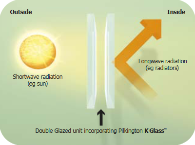

Also K glass™ may be an option. I think it acts as a one way valve, but which way, can it be reversed summer and winter, so in winter it lets the heat in and not out, and in summer lets heat out and not in?
I don't really understand how it works 1657187798539.pngbut remember some problems when installed wrong way around. There is also add on films1657187964390.png which I know work, as seen it used on a batching plant cabin where the sun was making it very hot, often referred to as one way film, as it can stop one seeing what people behind the glass are doing, definitely needs to be right way around in a bathroom, if some one thinks it is a mirror they could give a good display.
I don't know what "K glass" is, but I'll try to find out when I have some moments. However, as I and others have told you, any sort of glass (at least, any sort I know of) will exhibit the 'greenhouse effect' - i.e. it will let in enough UVA that sunlight will be able to warm the inside of a building, but will prevent heat (IR) escape by radiation through the window (but some heat may go through by conduction, if it's cold outside).
I suppose one could put a UV-reflective coating on the glass to prevent the inside being heated by sunlight, but I don't think you could do anything about the fact that IR can't get out of the room through glass - so I find it hard to see how it could be particularly 'reversible'.
If I discover more, I'll let you know!
Kind Regards, John
I presume he means 'Pilkington K' glass?:
Thanks. The description seems to suggest that it reduces even further the transparency of glass to IR but, since I thought that was pretty low in the first place (with 'ordinary' glass) I wonder how much benefit it actually provides?
... or is there perhaps more to it than that?
