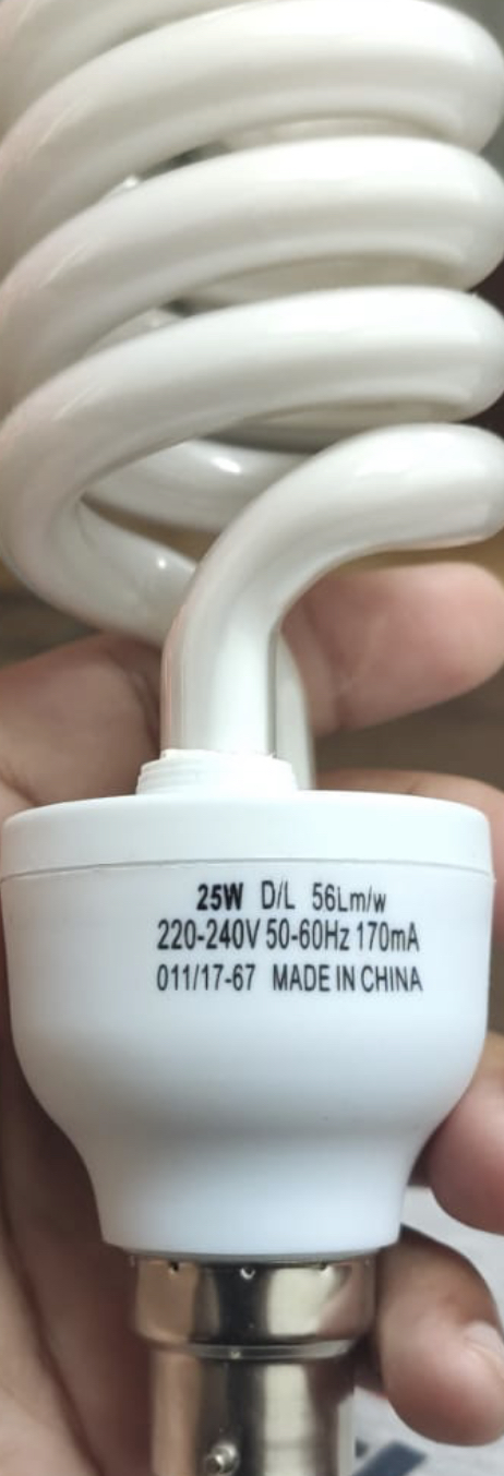

My folk have a number of light fitting in the house that have these bulbs. Some of the lights take 3 bulbs. They thought these were the energy efficient LEDs but I’m not too sure.
Can you please advise on whether these are energy efficient or should I replace with something else.
I think they are an eBay special!
It is a compact florescent. Generally about 5 times more efficient than traditional filament light bulbs so would be classed as energy efficient. LED may be slightly better but you will not recoup the cost over its life. So don’t bother to replace until it fails.

Is the mA reading significant?
My research suggests that modern LED bulbs are much lower in the mA they draw.
Up to a point - less mA is less power (watts). However there is the issue of power factor, so it's not necessarily a direct conversion.
In terms of power:
Compact fluorescents typically 20% of an incandescent
LEDs typically 50% of a compact fluorescent, or 10% of an incandescent.
100W incandescent = 20W CFL = 10W LED.
LED and incandescent are full brightness immediately.
CFL take anywhere from one to several minutes to reach full brightness, and are therefore not suitable for applications where they are only used intermittently for short periods.
mA is a unit of current - 1/1000 of an Amp.
Voltage (Volts) * Current (Amps) = Power (Watts)
Bit more to it than that. There is something called power factor which has values between zero and one.
Volts x amps x power factor = watts. Power factor for lamps is never quoted but old CFLs and some LEDs are quite low.
Edit Flameport beat me to it.
Yes, I know. I also knew someone would pop up and mention it. But I didn't want to make it too complex
An electricity meter measures true power, so it is the wattage that you should be comparing when comparing lamps' power consumption, rather than the current, and there is also the efficiency and optics to consider. Even for lamps of the same wattage the effective or perceived level of illumination will vary depending on a number of other factors.
