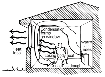

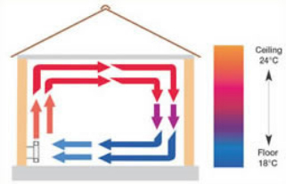

Because the air being cooled by the window convects down, and the air being warmed by the rad convects up, the two meet at around windowsill area and mix, funnelling out into the room.
I have two diagrams circulation.jpgcirculation2.jpgnot sure I agree with either, since my house living room two radiators at 90° to each other, but the comment pre-double glazing is valid, as I remember my first house, gas hot air central heating, warmed the house fast, but also cost a lot, because the fan moved the air around so no cold or hot spots, but noted first with mothers house, within her living room recorded in winter at same point of time 16°C and 24°C in her case it was down to bay windows catching the sun, but today in my living room 2 x TRV heads and a baby alarm all showing in my bedroom the living room temperature, 17°C, 18°C and 16°C some days there is more of a difference within the same room. All recorded low down, and this is a problem as the body hight temperature is much higher, my hall is often showing even more now showing at TRV 16°C and at Nest Gen 3 18.5°C the warmer the day, the less the difference, and showing 13.4°C outside at the moment.
There must be air movement possible as the diagrams show, but with such varying temperatures within the room, this must be very slow. In the old days, the cold air entered the room under the door, and hot air left up the chimney, I did see one house with vents by the fire so combustion air was drawn into the room local to the fire, but this was not very common.
