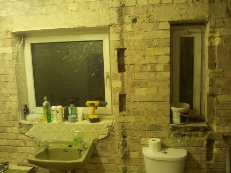

Enlarging bathroom window
but cant see why it wont work
Any thoughts on this?
Unless I've missed something, youre proposing making 2 prestressed concrete lintels into 1 lintel by joining them together with glue, metal rods and concrete, and accepting that it will have a chunk in the middle that is not prestressed, and the 2 parts are secured to each other by a system under tension rather than compression?

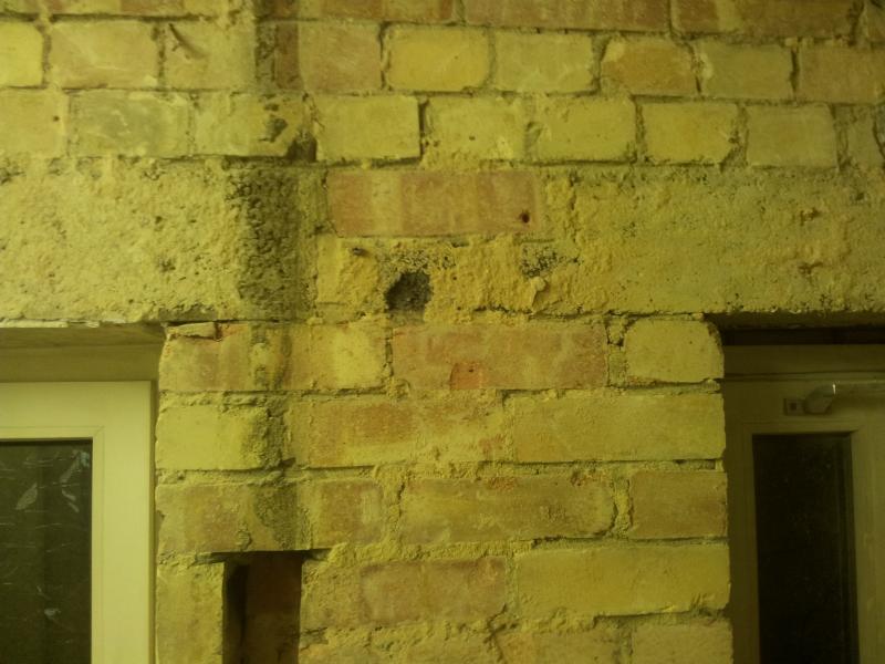

The intention is/was to drill 4 axial holes to a depth of 100mm into the faces of both lintels.
Hi Jack,
Hilti HIT RE500 is designed for use into a drilled hole, I suspect in this case the intention is to grind out a slot and bed the rebar in the resin at the bottom of the slot. This is a standard technique but not one that we have any experience of so I’m unable to say this would work.
If you can drill the lintels axially and then resin the rods into the resulting holes then the task becomes a standard drilled in rebar application HIT RE 500 is an appropriate resin mortar for the application.

In principle this method is fine however I would expect the hole depth to be deeper, something like 300mm, to ensure continuity of load transfer between the concrete and the reinforcement over the full length of the lintel.
With the short embedment depth that you propose you would potentially get a brittle failure of the lintel near the connection because the load could not be transferred between the original reinforcement and the small length of concrete where the anchor is drilled in, to the new reinforcement.

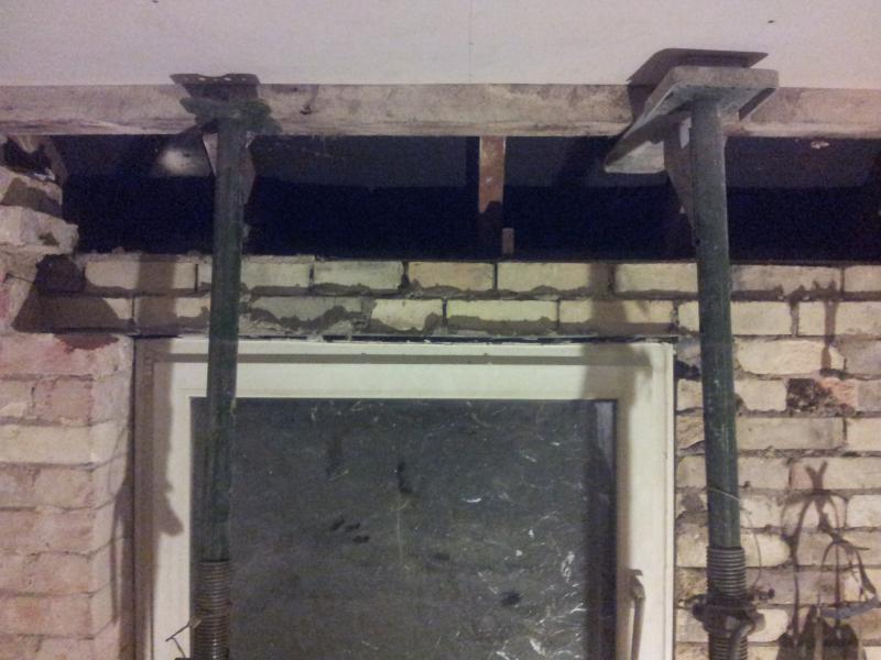

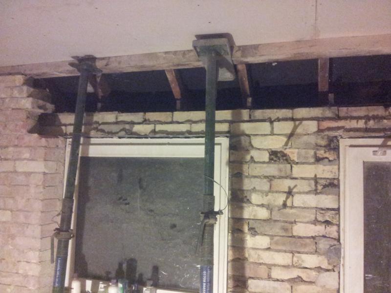

Had the acros delivered on Friday and thought i'd have a go at it the weekend-
So far so good- just need to watch the weather now & catch a good day to get the outside done.

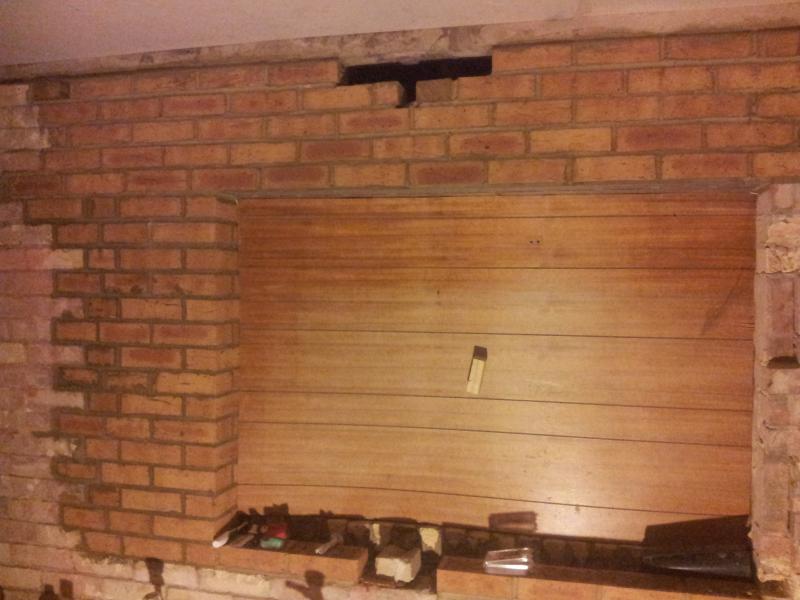

Was meaning to update the post with a picture of the lintel in place but didn't get to it.
Lintel in place and bricked up- still waiting for the window to arrive before making an appointment with Bco to come & inspect it.
Regards
Jack
Looks a really good job Jack, could of been done by a pro.
