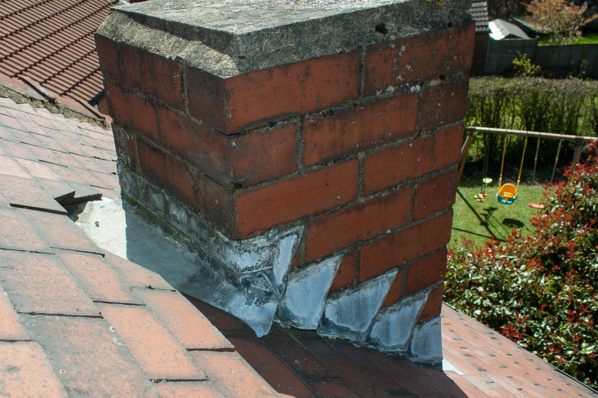

Why not post pics of the stack on the roof - from the ground and from the "loft window"?

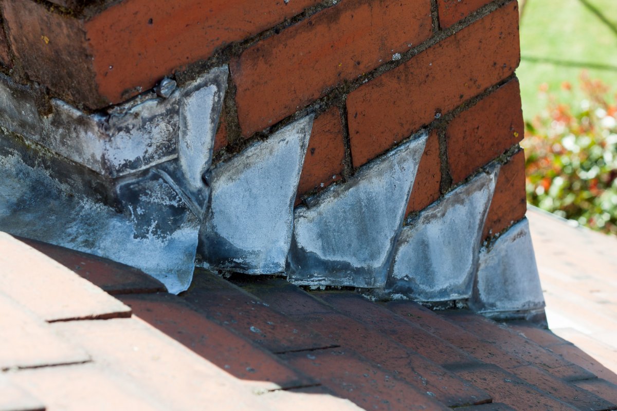

This was originally a small secondary chimney for the original 1930s aga. It is about 40cm square (external measurement). It was removed at kitchen level some 40+ years ago but the breast was left intact at first floor and the loft. The stack is still present (it seems to have been reduced in size) but was also capped off.

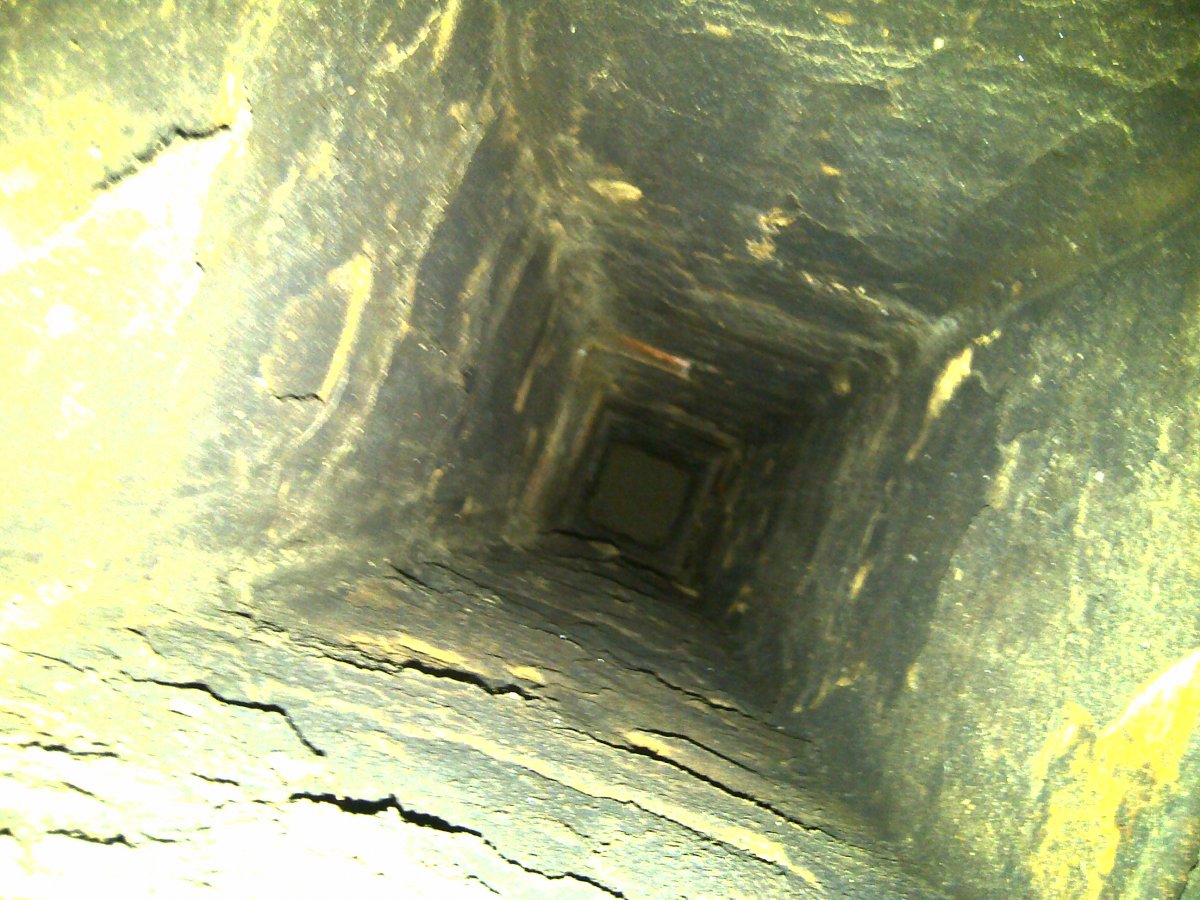

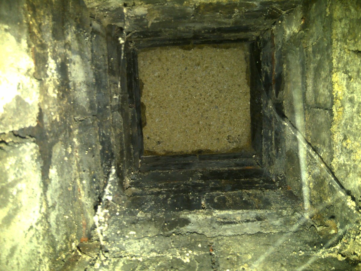

The damp does seem to get worse on either cold and or wet days but there is no sign of a leak. Inside the flue looks dry to look at. The exposed brick in the loft is dry, there does not seem to be any dripping or obvious leak.
Flashing looks OK. The cap is not the best but it is hard to say if is letting water in or not.

See pictures above of stack.

Here is an image on inside the flue. From the lowest point looking up and the highest vent, also looking up.
