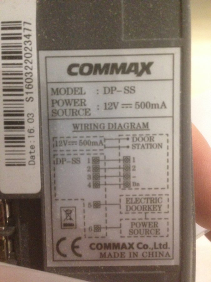

We have moved into a flat and the entryphone needs replacing. I have the following handset at the moment
http://www.intercomsrus.com/handset pdf/Entryphone 5901 Intercom Handset Data Sheet.pdf
It says L Speech In (Speaker) P Speech Out (Mic) B,F,G Common (what's common?!) A Call 3 Lock (Button 1)
and the new one I have purchased is the following
http://www.exterior.md/sites/default/files/dp-ss.pdf
The wiring diagram at the back of the handset is attached
Which cable goes to which number?
I really appreciate if someone can help. I have messed up the wiring and no longer able to use the system
Many thanks in advance
Why do you believe this replacement is compatible with the system? See the last paragraph in the first document you linked to.
I would try:
Old --> New
B/F/G --> 3 and 6
A --> 4
3 --> 5
L --> 1
P --> 2
The last two are just a guess; they could be the other way around. I'd leave them disconnected at first and see if the other connections are sufficient to make the buzzer and door release button work.
