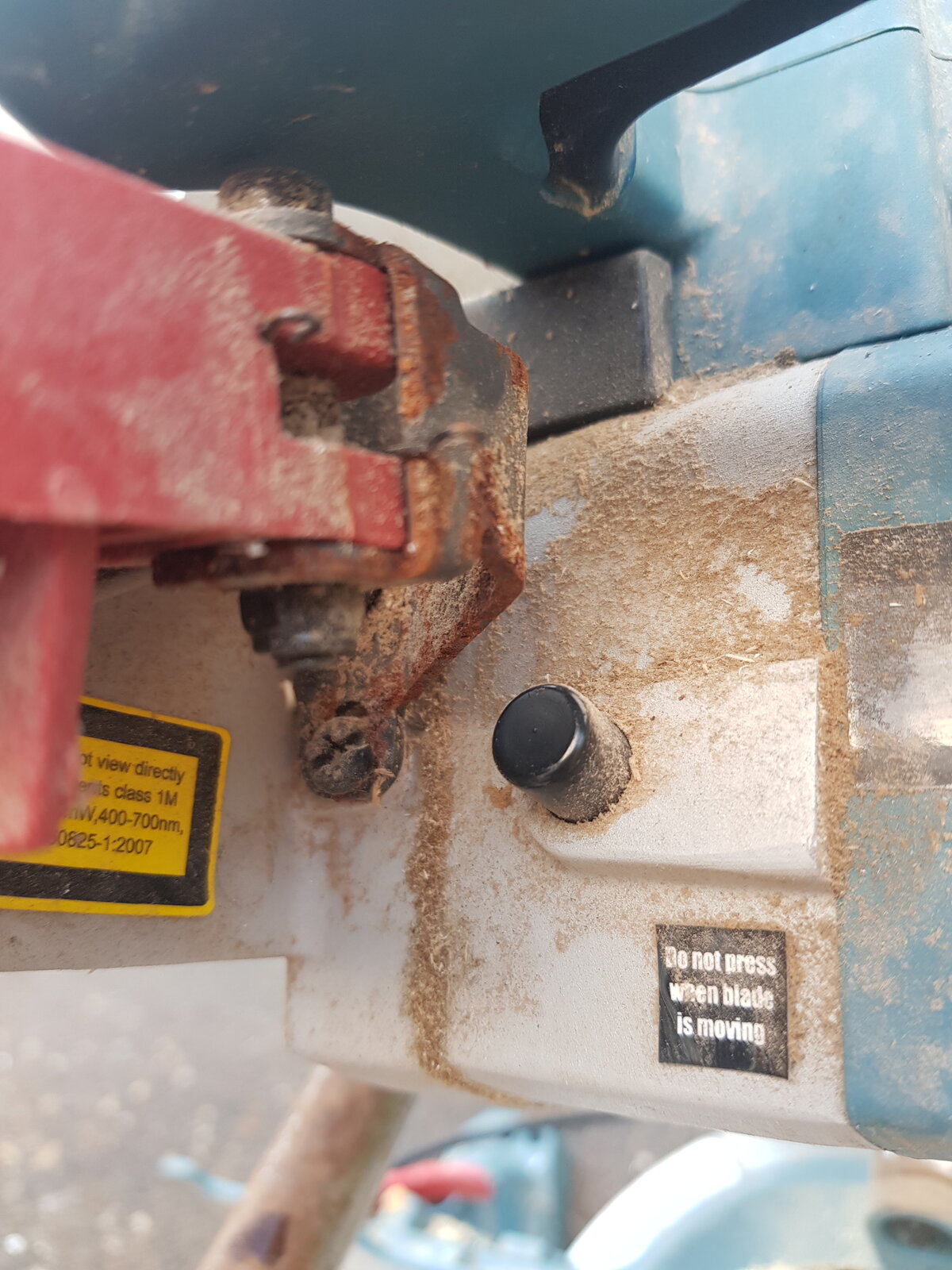

Hello, my mitre saw blade no longer spins, the motor spins as normal on the button though. Any suggestions appreciated. Thank you
probably the securing bolt that hold the blade on the arbour[spindle] needs tightening more than likely a reverse thread
Thank you, I've just looked at the saw and the safety switch doesn't seem to be connected to anything? I've attached a picture, should this press the black button behind it? Thank you

that button should lock the blade

I am confused. The button looks like a spindle lock button. If it is, then when you press the button it will stop the blade spinning so that you can either loosen it or tighten it.
Based on the the way that I have read your posts, the blade sounds loose and the button is not a safety button.
Thank you everyone, I'll try and find an exploded diagram for it. Re the button, it seems to do nothing when pressed and I turn the blade (with no power).

But the red button on the handle I thought was a safety switch, I'm convinced something has fallen/broken off as it does nothing, it simply moves on the bracket back and forth, nothing connected to it and it touches nothing now.

press and hold in the button and tighten the the nut or bolt holding the blade in the center' the button should jump when the groove lines up and it locks into the shaft
Thank you, the button doesn't hold the blade sadly. I've taken it all apart and re the picture attached, the end I'm holding is where the blade is bolted on and the other end is the cog that engages with the motor and the blade lock button. When I turn it the cog turns but when I turn it and hold the cog it still turns so the issue is this I assume? I'm unsure if this part is available or fixable. Many thanks
