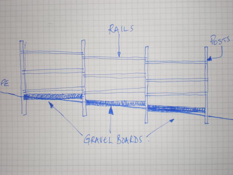

My apologies Matty for the carp image but what I mean is this
You see that each set of rails is slightly lower than the ones before. This will not solve your problem on a very steep slope however on a slight slope 'panels' are dictated by the steepness of the slope so can be longer than the normal 6'.
One drawback is that I would suspect there will be more wasted materials than in the normal design.
Gravel boards are designed to be in contact with the ground, and are there to protect the fence above. In theory, the gravel boards rot first and then can be replaced. The fence should last a lot longer.

Yes that puts me in the picture now thank you.
I get the idea, the gravel boards then need to be extra deep so there is no gap for meeces to get through etc & the rails are not in line but stepped down per panel with the close boarding also being stepped down between each posts or.... staggered while in line & perhaps trimmed in situ.
How does that sound?
Will it still work with the rails following the angle of the slope?
That way longer rails can be used without so much wastage.

Yeah, absolutely, if you are going to follow the slope then everything will follow the same line, gravel boards, rails and your cuts at the tops of the boards.
Just remember to leave enough boards over to trim. I used a hand saw after snapping a chalk line when I trimmed mine to match a slope as you can see from my first picture.
