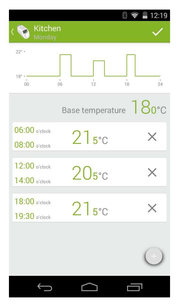

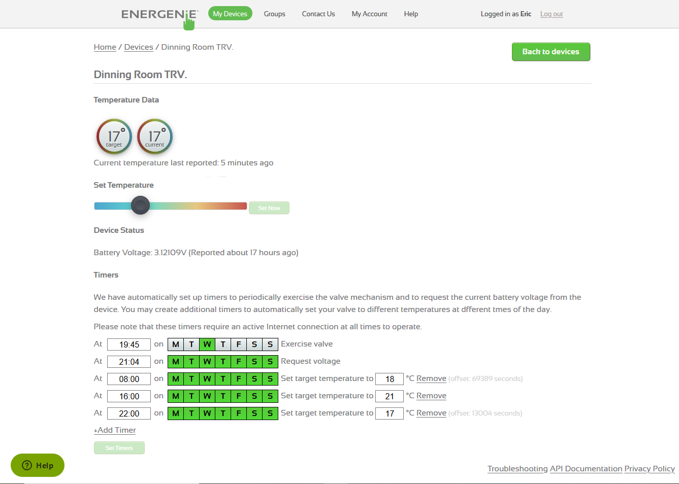

But can't have a wall thermostat programmed for different temperatures through the day, unless the TRV is also programmed for same changes. So you set the TRV like shown
or with more expensive version
So you match with wall thermostat, depending on make of wall thermostat some can be set to link with the TRV, mine was claimed to link, but to be frank since I need at set 2°C lower than wall thermostat it does not work, I have Nest wall thermostat.

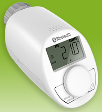

However this 61dmtMm13BL.jpg cost £15 with bluetooth, can get them for £10 without bluetooth and I have them in 5 of my rooms and they work well, except they only show target temperature they don't show current temperature. Called a eQ-3 there is also the terrier i30 which does the same being a stand alone unit, the bluetooth version of eQ-3 can be paired with other units as well when you have more than one radiator in a room.
