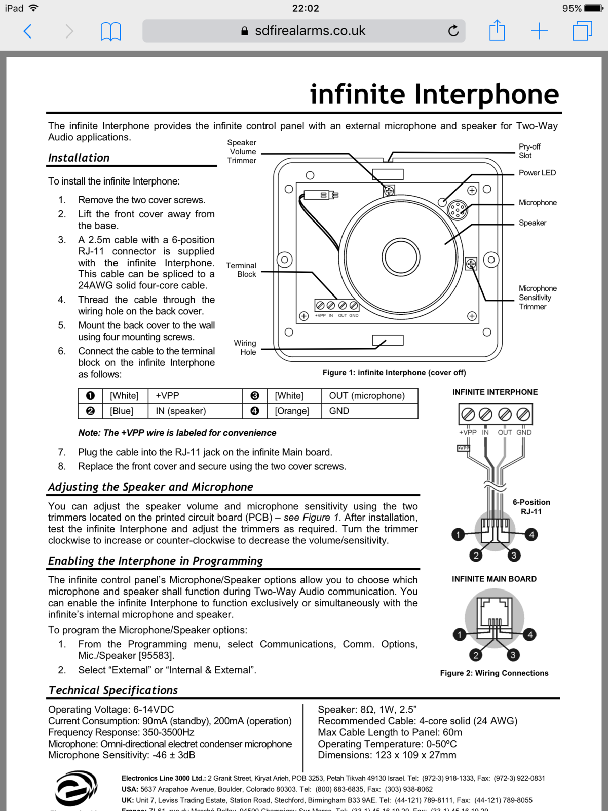

This is still a great alarm system, and one I have extended with a wired keypad.. sadly however the pad doesnt pass on the alarm arm/disarm sounds as i had hoped. (see main panel not by front door)
has anyone extended the sounder from the main panel to another location using something similar in speaker size/mlar?
thanks

in the manual or on the speaker will be its specification. you can get speakers in a variety of formats. that will look okay and do the job, just need to find out what its rated at.
IMG_1847.PNG Not sure but may work
Had a quick look at the manual looks like the intaphone may be the easiest option but don’t know is there no tech help, Risco do this?
was thinking more like the alarm speaker extender units about..(CQR Alto Internal Alarm Sounder) comes in at under a tenner normally
probably to the cable inside the main box that supplies the builtin speaker?
