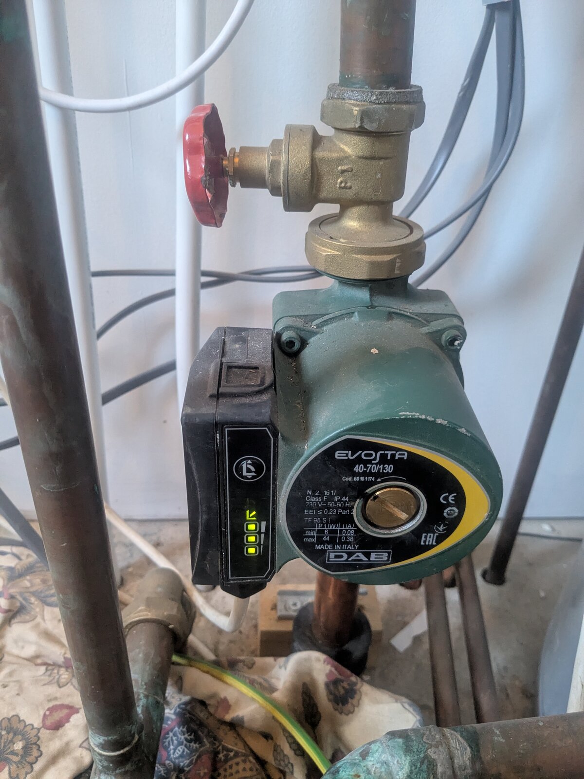

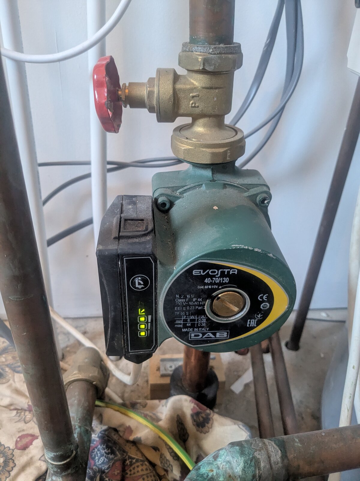

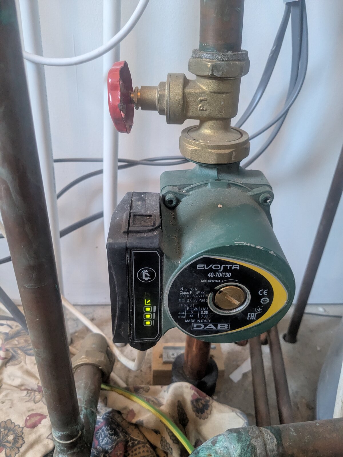

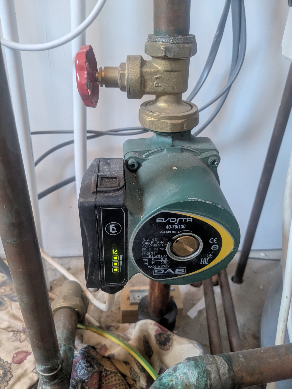

The manuals for these pumps are a bit baffling...
I think this is showing an error code -, flashing twice - in the casting a blocked rotor -, but when I isolate the pump and remove central plug, nothing else comes out.... In their trouble shooting videos you can remove a part and see the rotor...
Confused!

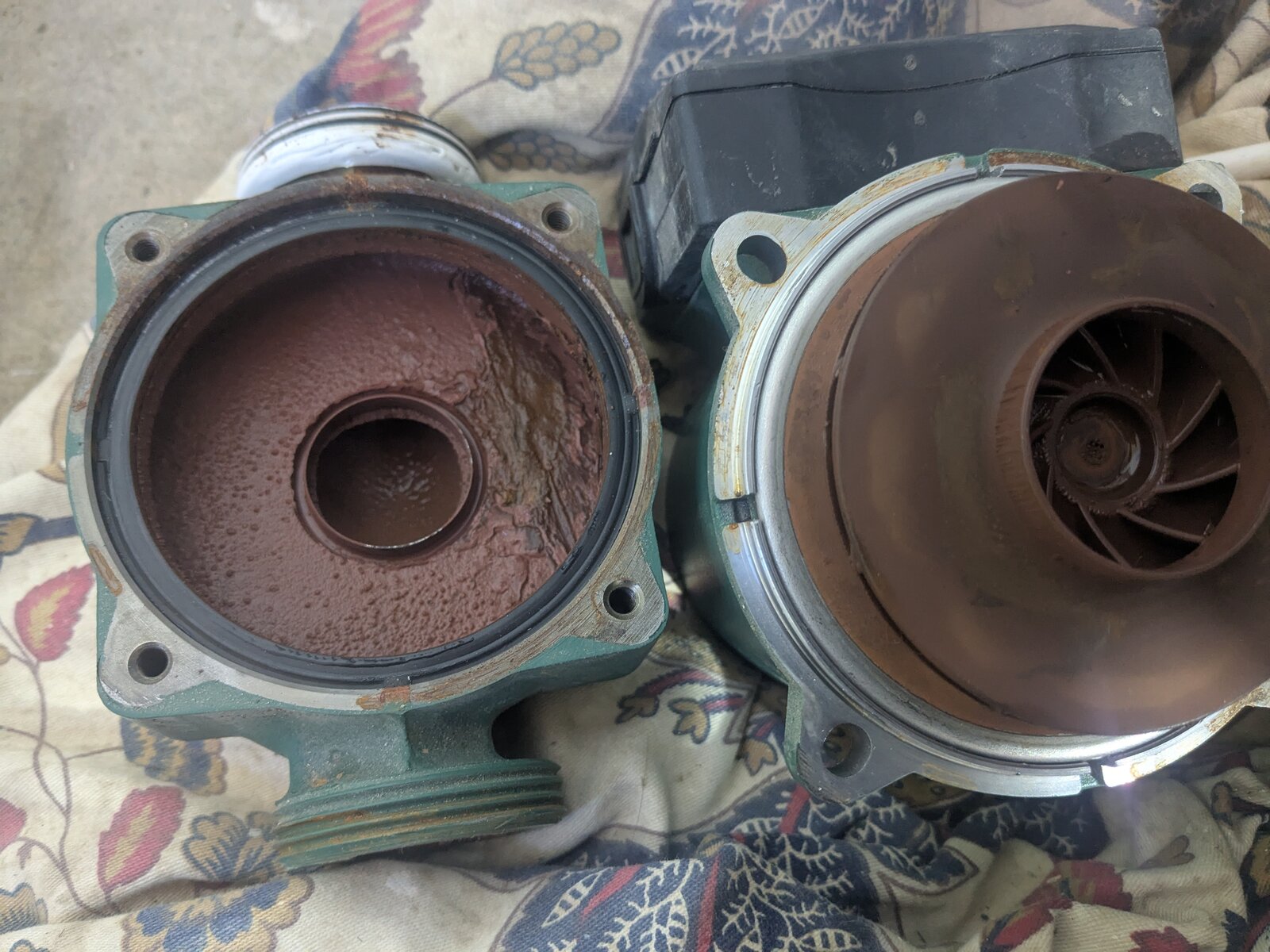

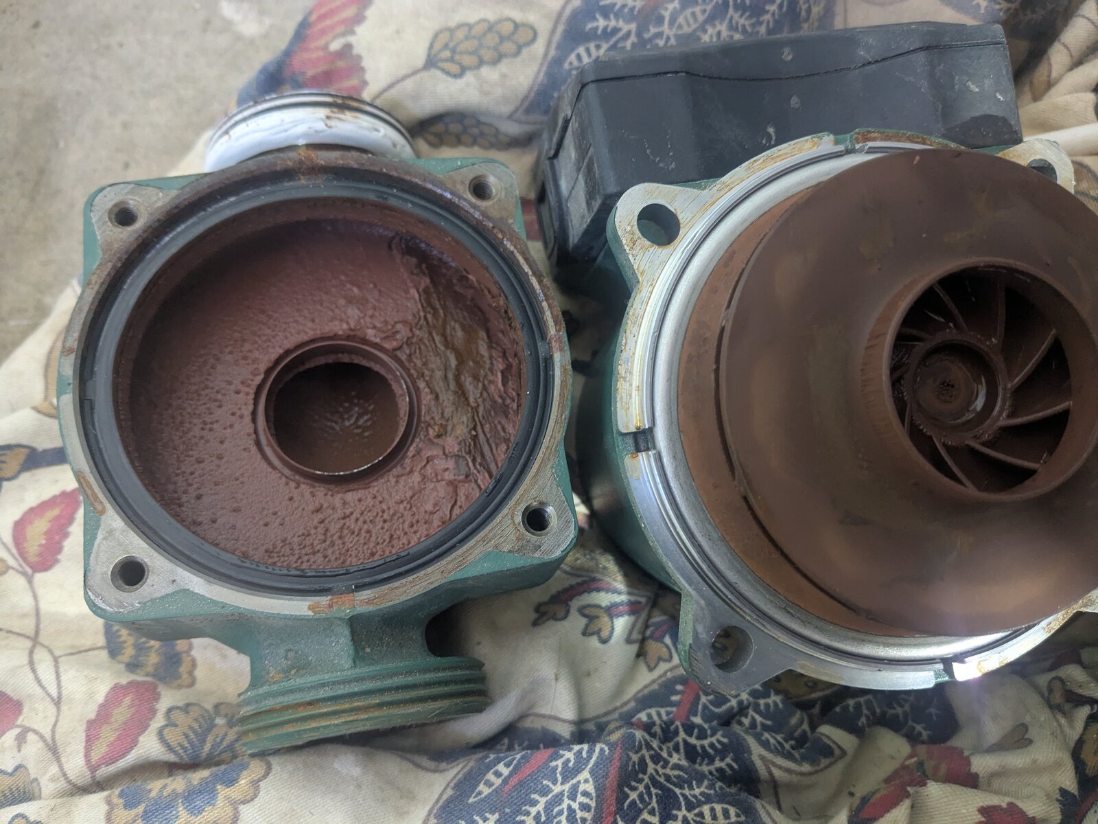

Pump off, taken it apart...
Spins freely... Though weirdly rusted inside.....
