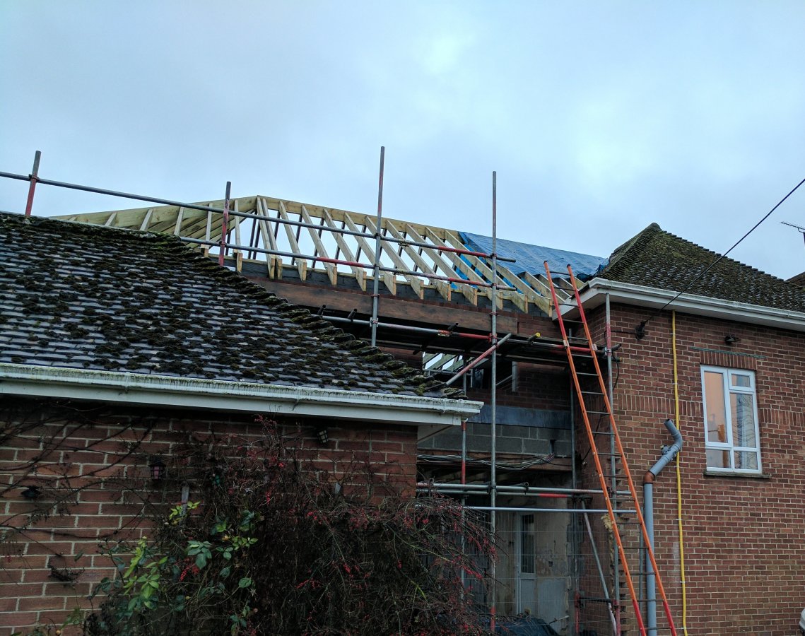

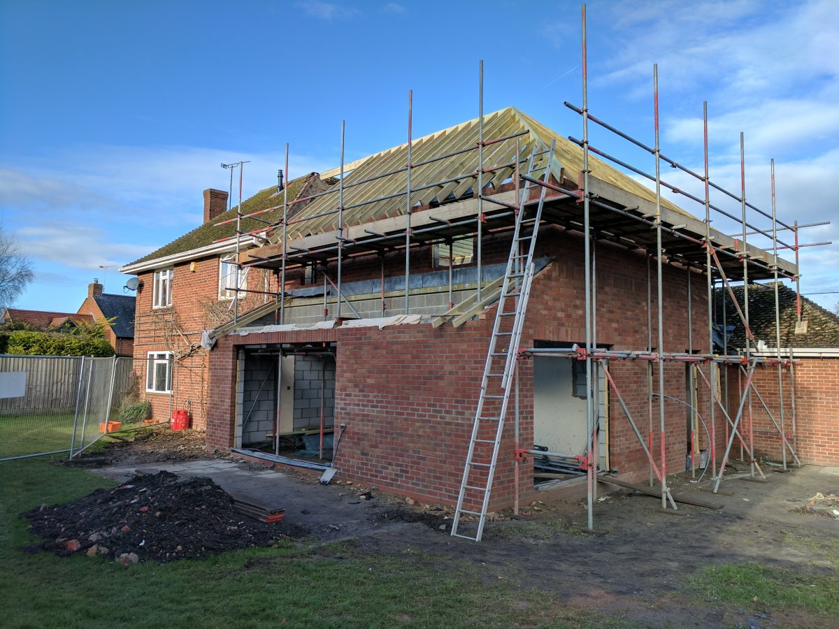

Trying to upload a couple of pics of the roof before the battens went on so you can see how it ties in. Hopefully this works ...
OP,
Thanks for the prompt pics.
Can you be more exact as to what tiles you have - there are various gauges for various plain tiles by various Mfr's - eg. Marley Concrete plain tile or Rosemary plain clay tile etc.
I'm assuming that all the common rafters on one plane of the roof are the same length.
And all the common rafters on the other side of the roof are all 16" longer.
FWIW:
From what I can see in the pics, and allowing for an angled ground view, your rafter framing should work out with a few jiggles.
There are different ways of doing irregular pitched roofs but where you are intersecting with another pitched roof it narrows the options.
you are governed by the existing roof in this case.
The bonnets need to course round. so is the existing gauge 115mm or 100mm (I expect 4 inches)
are the ridge heights the same?
Pitch looks about 35 degree ..

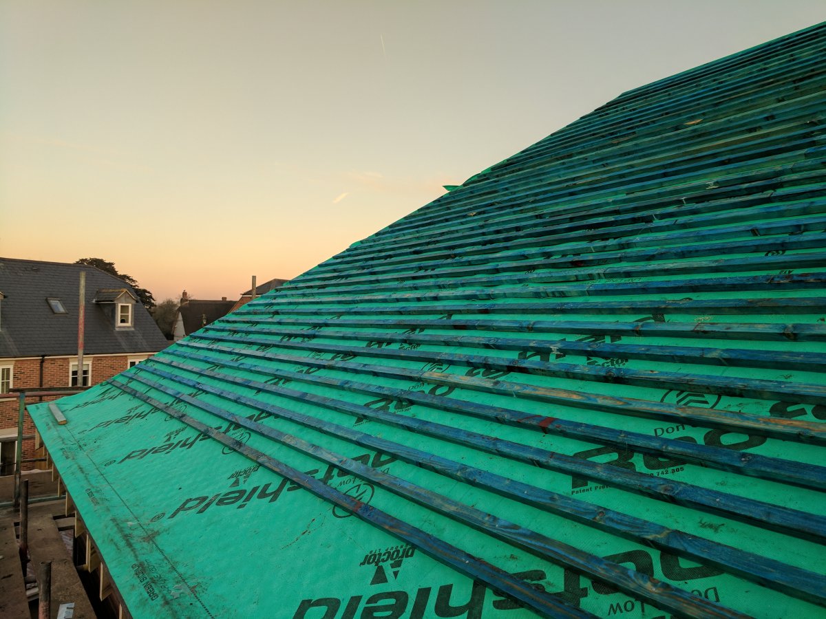

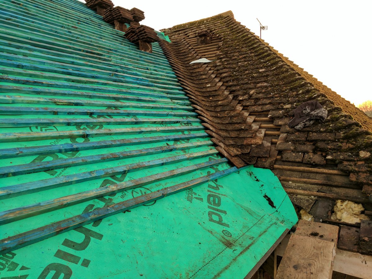

A couple more piccies which might help:

the vally could have been lead or grp then it would not have needed to course, making the hips easier.
OK. The guys were keen to tie it in with tile to make it look cleaner.
So, how worried should I be (if at all) about the width between the battens? I'm sure the roofers won't want to re-do it and will play it down if I ask them directly.
width between battens? have you measured top of batten to top of batten??
The pitch of the roof looks about 35, This is the minimum recommended pitch for plain tiles.
The max gauge appears exceeded.
If you had an issue the manufacturers will walk away.
Your guys certainly won't want to rebatten, that would mean new underlay too..
4.25 battens will likely get wet. 4.5 be worried..

Should have lost the valley.
The new underlay would have been better under the old at that point too.
Tricky but good practice
whats done is done
Agree with Data. If the pitches differ then the gauge will also differ due to the longer rafter length etc. They should have forgotten about the valley tiles and had a dry valley, giving a definitive break and set out an independent gauge.
