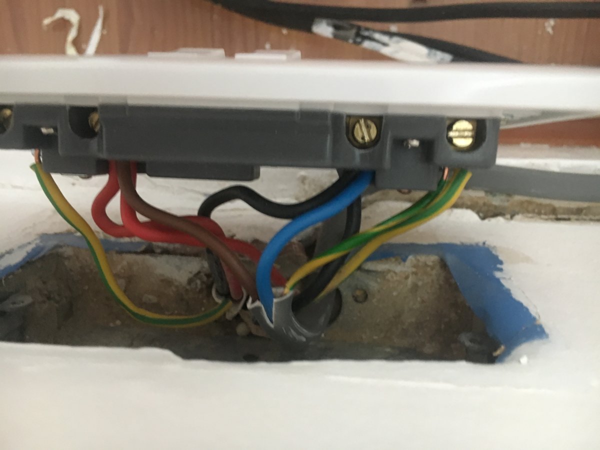

Expanding foam over electrical socket!!
The earth wires need properly sleeving and connecting to the earth terminal of the socket (urgently!). As everything is looking rather poor at the moment, I would strongly recommend calling an electrician (not a builder!) who will be able to tidy everything up properly. If there is more of this style of wiring, a full electrical condition report should be carried out on all the wiring.
Hopefully this looks better had someone come round and sort the main socket
And also fit a fused connector
So it goes main socket / fused connector / extra socket 1 / extra socket 2

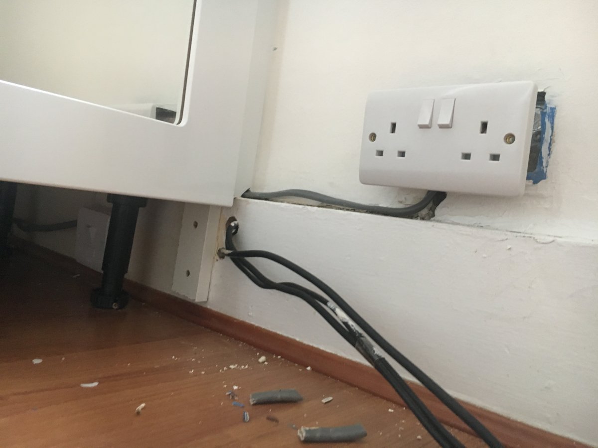

What's happening with that cable out of the bottom of the double socket? Is that the finished job?
You mean they grey one that runs along top of the skirting board and to the fused connector?
Going to get some d line trunking
If you mean another cable please can you let me know which one mate?
Don't put them in the same trunking as the electrical cable.
That FCU is in a daft place, BTW.
What is the risk of putting them in same trunking may I ask?
They are actually going to be going in the opposite direction but would like to know :)
The fcu I didn't want on show. So thought best place to put it is under wardrobe and it will all get hidden by a front panel anyway......
Only really see fcu in a kitchen!
I only added it as many people said TWO spurs was too much from one socket without a fcu.
It actually had TWO without fcu for last 15 years and there has been no issue lol
The risk is, to be fair, pretty small. But the Wiring Regulations prohibit the mixing of cables of different voltage bands unless they are all insulated for the highest voltage present, and those TV cables won't be.
a) I can't see how it qualifies as accessible for inspection and testing
b)It will be a PITA to get to if the fuse ever goes, and when you sell the house FGS leave a note for the new owners to tell them it's there.

I got the d line trunking and the panel at the bottom that will cover it will be open able not glued down so should be ok to get to
I tried make it as co pliant as possible,
I was more worried by the foam on the electrical cable than the spurs tbh as they have worked without fcu for years but anyway best I could get it too now
