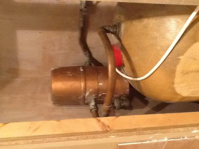

We burn smokeless fuel and logs. Think it was installed mid 90's and by a plumber and a builder. It's a Hamlet inset stove with a back boiler which replaced an open fire.
Yes, and it must have a vent, the Hydro-spartan will provide that somehow.
Can't see the connections to the cylinder.

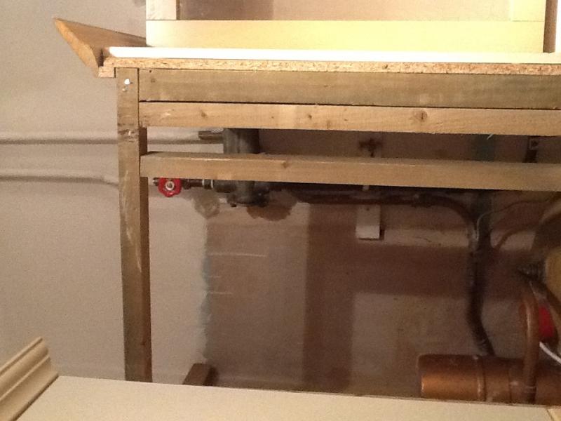

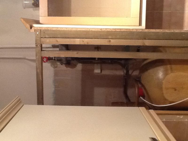

There is one more connection coming out the bottom of the Spartan cylinder. Can't get in to take a clear picture. The air vent is the smaller grey colour cylinder on the bottom left. My apologies but this is my first time on this site and I haven't worked out why my pics turn sideways and how to sort it.
The pipe at the back is the interesting one that should include a vent.
Can you post a pic zoomed out so it has more detail.
I am. Sorry. The pipe at the back is the hot water pipe which goes to the bathroom and then back into the kitchen sink.
