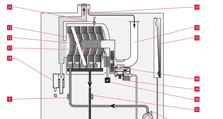

Hi, we are looking at getting a 2 emersion pressurised hot water tank fitted & it will need an expansion vessel. Will it harm or help the hot water if we fitted a larger one.
Q&A 2 if i can. Our boiler is in the loft next to where this new hot water tank will go & has an 1"&1/2 waste pipe going from the boiler to the bathroom below & joins on to the Bath waste & into the drain on our bungalow. This is from a pressure valve on the boiler. This new tank says in the instructions to run a 22mm coper pipe direct to the drain. Could we not get away with using the same waste as the boiler. ??? As it will be a real pain to get a copper pipe to the drain. Thanks

Boiler discharge shouldn't be put into waste should be run outside in copper. Or on a dedicated connection ie not shared with anything direct into a soilpipe.
All unvented cylinders come with the expansion vessel when new. Although if you get a megaflow, santon or rm internal or gledhill internal you don't need one. As they rely on an internal air bubble.
Unvented discharge the d2, from the tprv and multiblock should be in copper to outside but could be onto a flat roof for example. If it goes into a waste system it has to be on a dedicated leg and using mupvc pioe ie pushfit/mccalpine. It cannot be teed into a bathwaste.

Ah! well done & thanks. The push/glue fit pipe going from the boiler in the loft & connected to the bath waste is dedicated waste pipe all the way to where it connects to the bath which is about 1 meter from the outside drain. So if i separated it from the bath waste & made it direct to the drain, would this be ok. Oh! The waste pipe to the boiler i now see is just from the ultracom condensation trap. Number 10 in photo & is just a flexible plastic pipe from the boiler.

It needs to be high temperature rated plastic, so either MuPVC / PVC-U solvent weld (not the standard ABS sold in most stores) or push-fit polypropylene. Standard ABS solvent weld waste pipe will soften, buckle, and potentially split in the event of a high temperature discharge.
PVCu/uPVC is standard waste pipe...needs to be muPVC or cPVC ...ie. modified or chlorinated PVC.
Must admit i can only find 32mm MuPVC pipe & fittings. Which is ok as its a 9m run with 2x45 & 2x90 sweeping bends, so boarder line for 22mm.
Hopping i can find a 22 to 32mm reducer in plastic. MUPVC. Thanks for the tip, & looks like we are running a 32mm MUPVC pipe to the drain.
