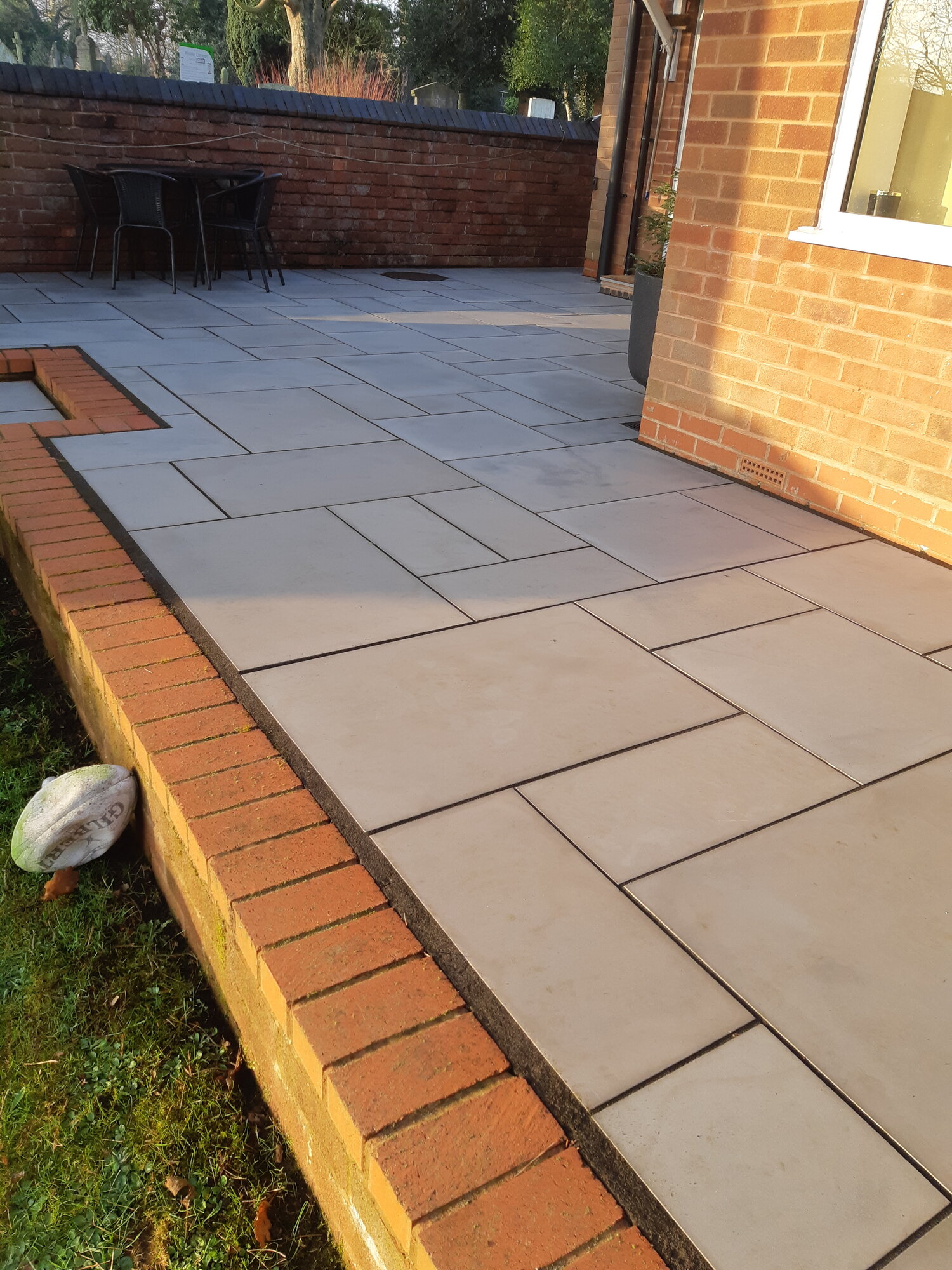

Is that the only job you did last year? Can we have more image variety please :rolleyes:
