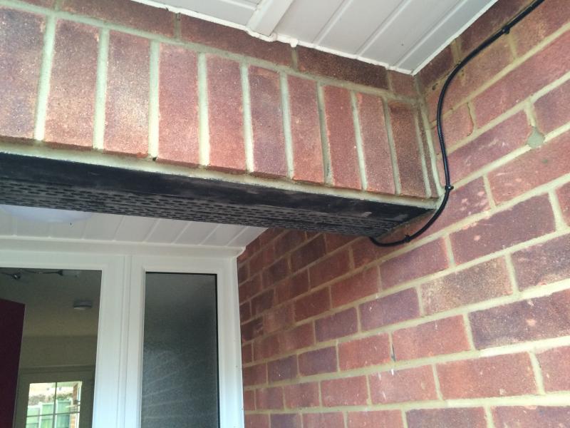

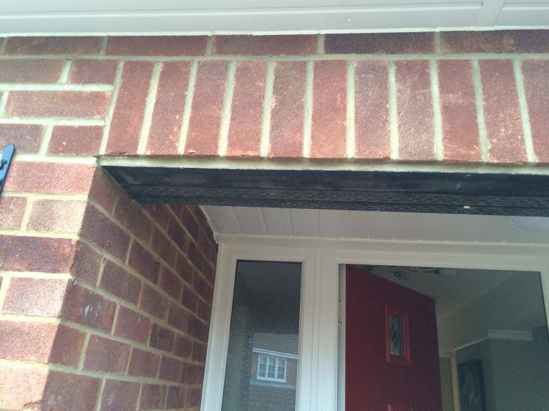

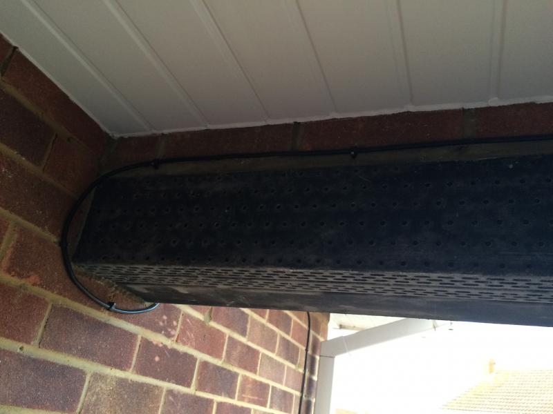

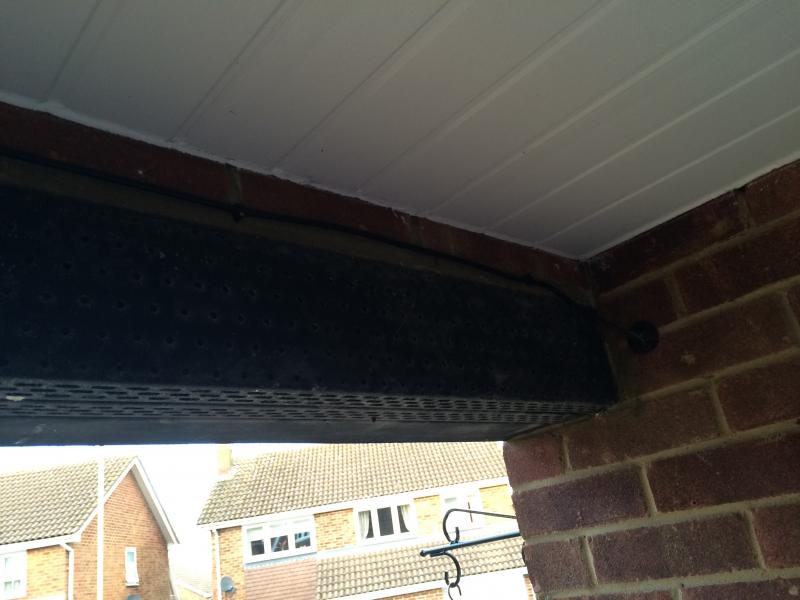

Hi,
I need some advice on an issue I have regarding a cold draft blowing up into our bedroom through a cavity wall underneath.
I will try and explain without pictures :)
We moved into this house over a year ago and whilst clearing it out noticed a cold spot on the floor in out bedroom above the garage. Being above the garage I thought nothing of it and may insulate the garage ceiling at a later date.
After getting to know the house a little better I noticed there is a box lintel supporting our front porch area and it runs from our study wall to the cavity wall below our bedroom.
Being a box lintel with lots of holes in I'm under the impression this is causing the draft.
Is it OK to fill this lintel with expanding foam for insulation and then cap it with UPVC for decorative finish?
Any idesa greatly appreciated, I can get some pucs if needed.
Many Thanks
Will.

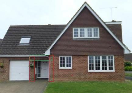

Hi,
I will take some better pics later, however to help the lintel is in the green rectangle and the cavity walls are shown in red. The lintel is face with bricks but behind is fully exposed. The red on the left is the cavity where the draft is coming up into the bedroom. Unfortunately I cannot show this from the inside as flooring is down.
I will take some pics later from under the porch.
The whole area above the lintel appears to be a cold spot inside the house.
Many Thanks
Will.

Hi,
From the first pic of the whole house it has the roof joists come down on top of it as its a chalet style bungalow.
I think from looking at it the lintel is acting as a cold draft feed from the outside to inside the cavity wall on the left which supports our bedroom above.
So can I fill it with foam and cap it in upvc?

I'm not an expert, I wouldn't fill it with expanding foam. Cladding in PVC won't give you 30 minutes fire protection.
What we did on our extension was cut cement board to fit slightly oversize to allow you to fasten the cement board to the wall, then paint it with masonry paint.
Wouldn't fill it with foam- if you do you'll trap any condensate from the air that WILL get in and give yourself corrosion problems down the line
Clad it with something by all means- plywood, plasterboard, cement board, whatever- but I'd suggest leaving a couple of drip holes in the cladding. Fire protection makes sense but not sure how well No More Nails will hold cement board up & drilling into the lintel for fixing isn't a brilliant idea
That whole area of your bedroom floor is "outside", though sheltered from the rain. The floorboards need to come up and the whole volume stuffing with insulation.
