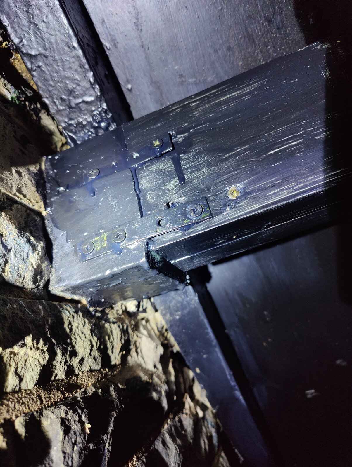

Hi,
The carpenter has been working on the purlins. This one on the side at the bottom right has rot. He says it hasn't been prepared properly in the past and water has wicked into the end grain between fascia board:
He has fixed the pointing on the wall, then nailed a piece of lead on the exposed side of the purlin and painted it. Says there is nothing to splice onto and if he was to do more it would be considered structural. That the rotten side is protected behind the eaves and rain doesn't go upwards.
Now suggests cutting it back with a chainsaw and gradually building back towards the rear soffit with timber packers. I sent a link to repair kits I found online https://www.timber-repair.co.uk/epoxy_repairs_roof.htm says this would be a superior repair, but not sure if referring to his method or the web link? Help!
Not sure covering the rot with a lead flap is much of a long term solution? And cutting back the timber and gluing on some more in its place will act as strucutral support for the overhang which the perlin serves as?

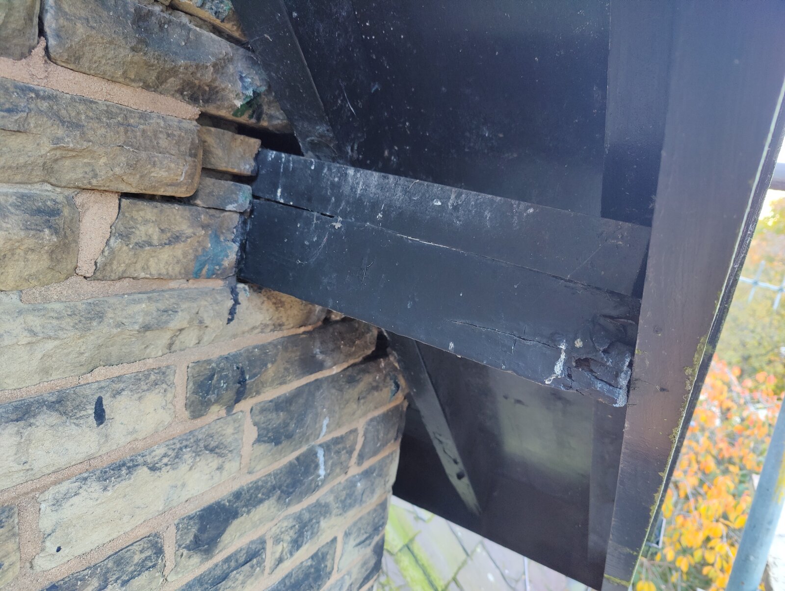

Hi @kp00110 not sure of the terminology but this piece of wood is right on the edge of the gable so can't access it from the inside, not sure if technically it's a 'wall plate'?
He is going to cut it back 2 inches to the wall and bolt on some hardwood etc. build it back up in 3 stages for a strong and long lasting repair?

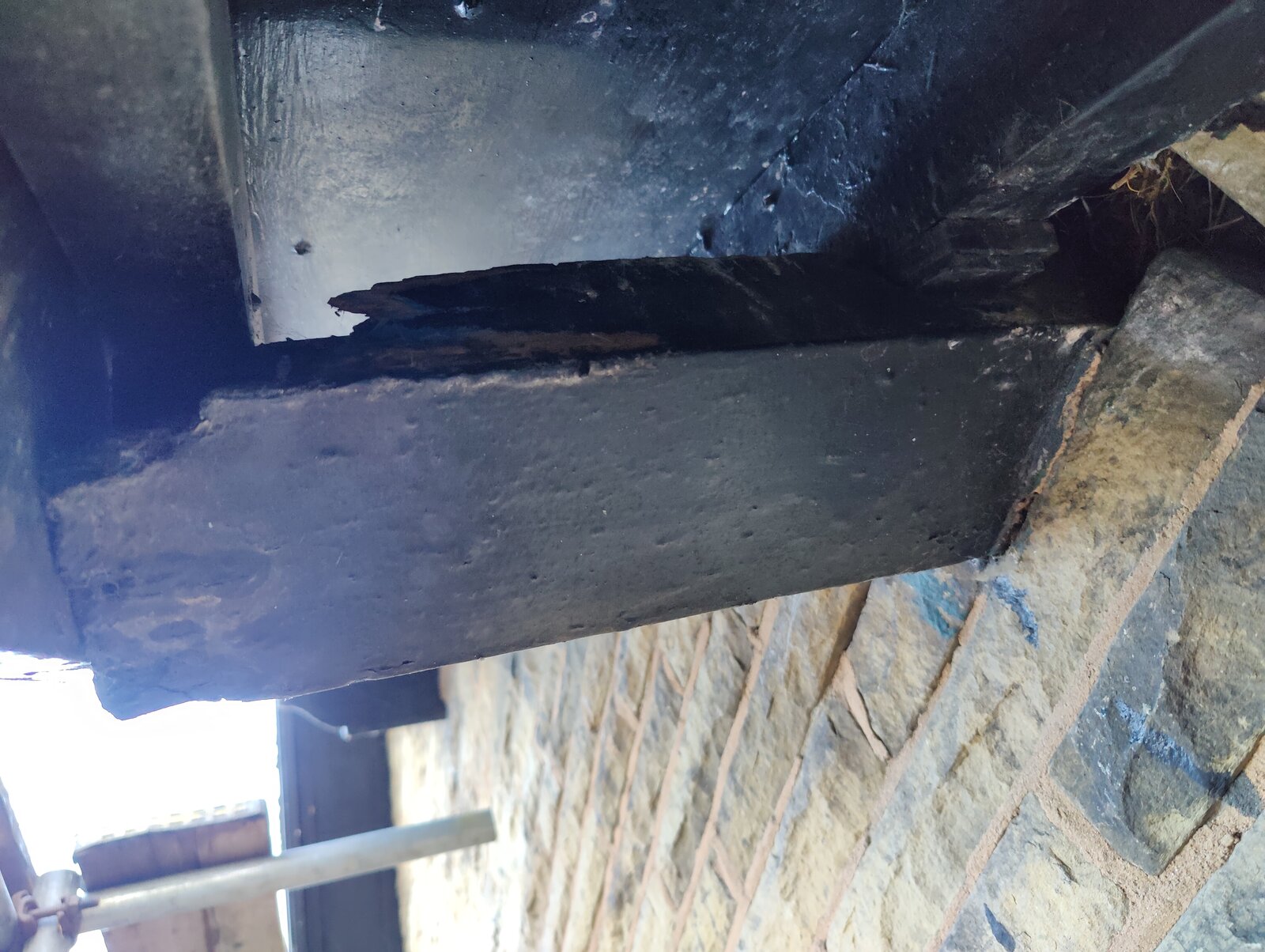

It was originally the size of a brick and only the size of a tolberone is hanging onto the fascia. Probably been like that some time I'd imagine?
Hi @kp00110 pushed into making a decision so it's now been cut, but if you look on pic 1 there was a piece of wood, albeit smaller but not rotten, on top of the rotten piece, going into the cavity.
So not sure if a previous ideal repair you mention has now been undone :cautious: ffs..

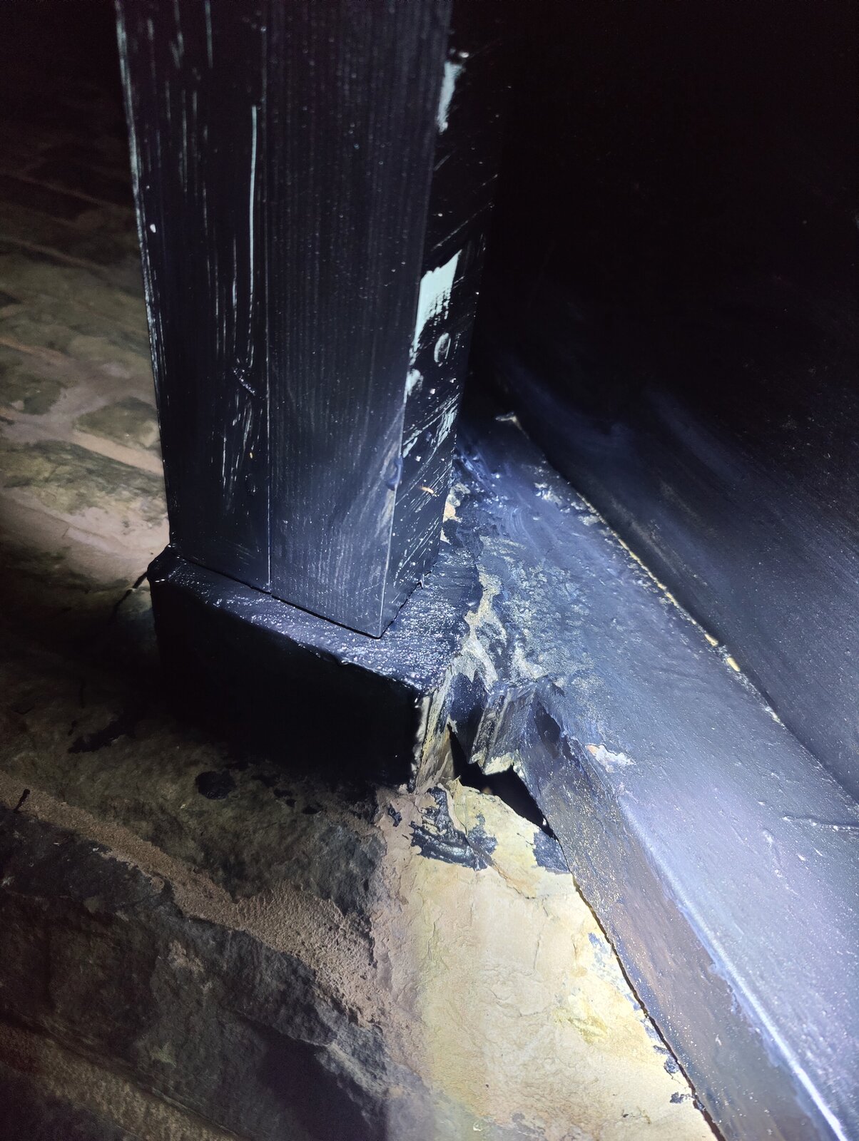

Right, I think both pieces of wood are original but possibly the front gable smaller pieces are long gone with the holes having been filled in.
Whereas this side gable corner is the opposite issue. So maybe this wasn't strictly necessary but hopefully will be stronger and more resilient than before..

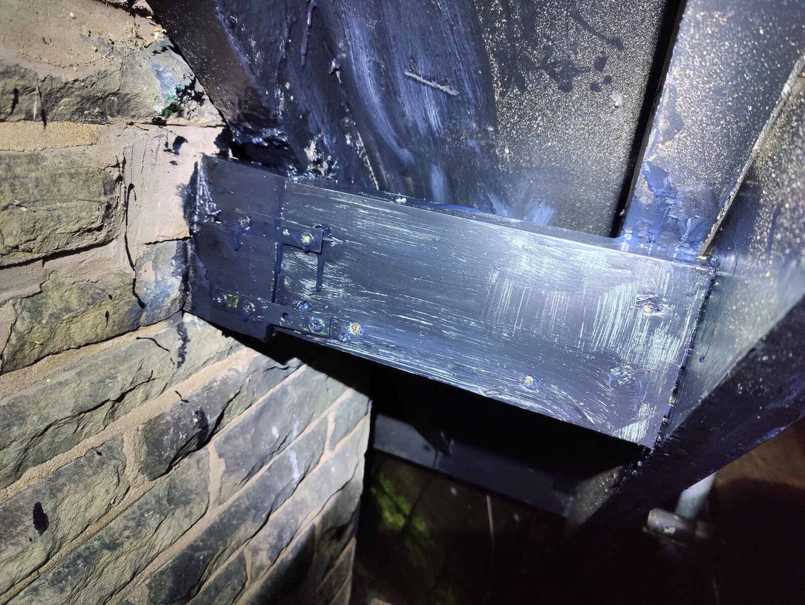

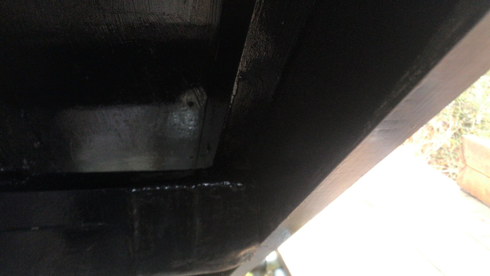

Does this look like a good repair?

Aesthetically, yes. Mechanically, no. It all depends on how much load bearing strength is required.
That won't hold the fascia under any appreciable load, but then again it has been like that for a long time.
Short of properly splicing in new timber from inside the roof space i.e. new purlin section, there's not much more can be done without obvious unsightly external support.
