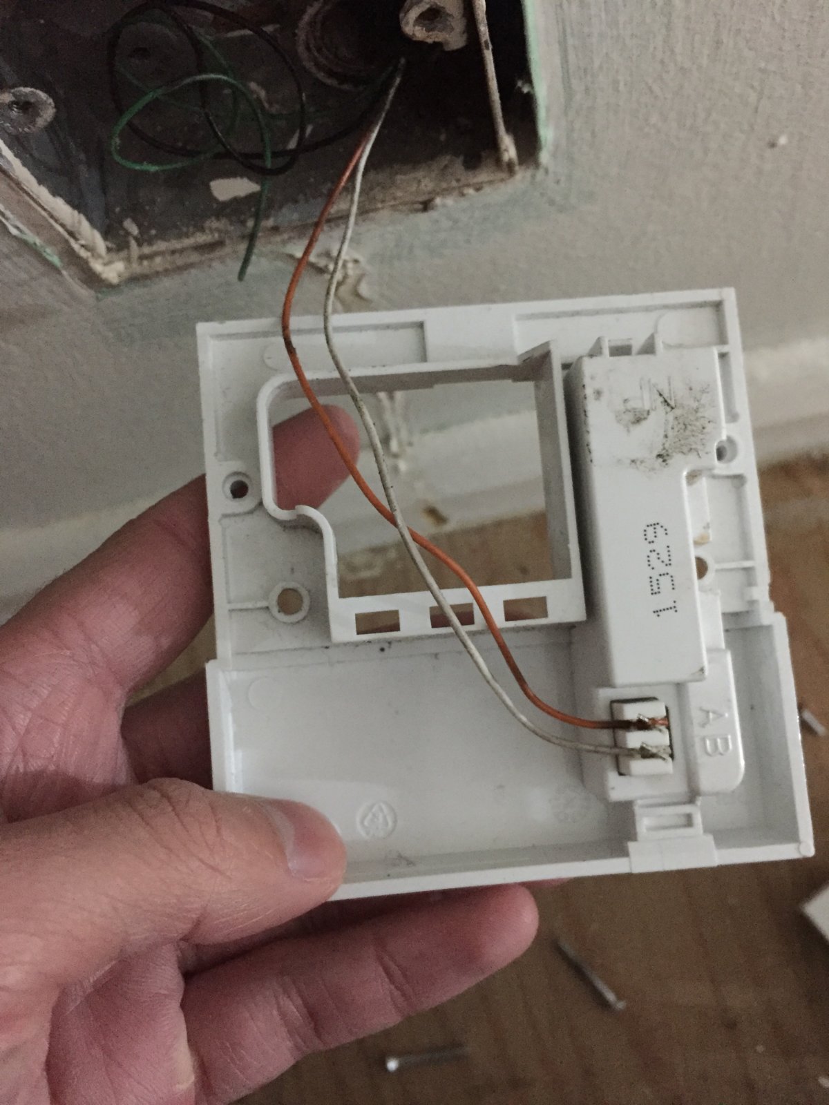

Read through various threads and youtube videos but my master socket looks different?
Picture attached, how can I extend this? Can I add another two wires into A + B (same slot?) then the new box would be two wires also? But what if thats numbered?
Box -NTE5
Extension wiring connects to the smaller piece that plugs into the front. Those terminals are for the incoming line only.

Potentially. Providing you use CW1308 cable (twisted pair - NOT alarm cable), and avoid power cables, you minimise this risk. You can always give it a go, and if you have problems, put it back.
I'd recommend recording your line stats in the master, then comparing when you put on the end of the extension.
