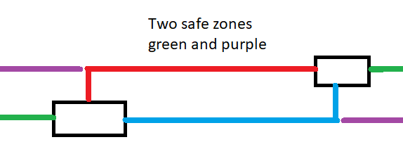

We are converting out garage into a living space. There are six sockets around waist level where bench once sat. We need to lower the sockets only a couple of feet lower. Would it be better to strip all the wiring and insert new runs (Means ceiling out and replace) or would solder/crimp and heat shrink work?

More sockets anywhere, however much higher or lower, create more zones - horizontally and vertically.
But if you have 1 socket at 40" high on the left of the wall and another, on the same wall 6' feet away (for example), which is 44" (for example) or higher, then the cable will run not run horizontally but at an angle, thereby running out of a safe zone.
As you say, you have to run them horizontally or vertically to create a safe zone. You don't automatically create a safe zone because you run a cable at an angle from the horizontal or vertical.
As you imply, that would not be allowed
No, but you can run a cable horizontally from one until it is 4" above or below the middle of the other one, and then turn the cable and run it vertically for the last 4 inches in the (vertical) safe zone created by the second socket.

And if a cable needs to pass along the cable route horizontally, without connecting directly to the socket, then it can go straight through the back box. Extra deep boxes would be an advantage here.
That's not actually allowed - unless the same zone is defined by a socket/accessory to which it is connected.
That would be fine if the cable were travelling in a safe zone created by one (or both) of the accessories into which that cable were terminated but, at least theoretically, an accessory does not create a safe zone for a cable that is not connected to that accessory.

Only if, as said, there is a socket to which it is connected in the same zone.
Don't get me started on rings with both legs in the same place.
Don't quite follow.
Can, for example, there be two 2.5mm2 T+E cables (on a ring circuit) running down a wall in the same oval conduit down to a socket box.
One cable connects to the socket.
The other cable runs through the box then goes horizontally along the wall in oval conduit.
Also in this horizontal conduit is another 2.5mm2 T+E, which also connects to that socket.
So is that ok?
