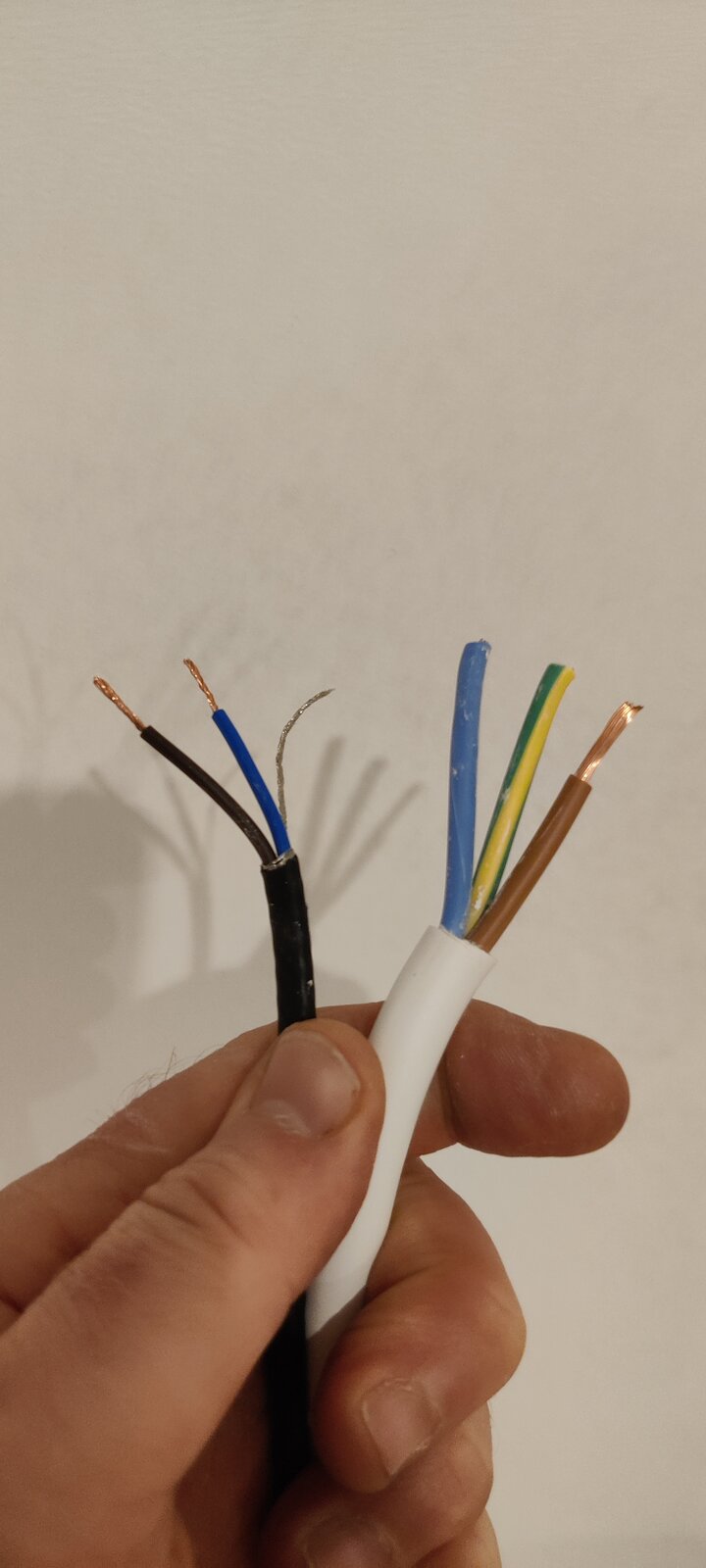

Had the task today to lay electric underfloor heating.
I used a 12sq/m roll and a smaller 6sq/m roll. The 6sq/m roll cold tails need extending by around 4m to reach the smart thermostat.
The recommended cable that I should use in the installation manual is 2.5mm flex. I've got the flex but it looks considerably bigger than the cold tails.
Can I use flex with a smaller cross section? The 6sq/m roll pulls 840w max.

What do the instructions say?
Last time I did this, the manufacturer said not to extend the tails.
Answered my own question tbh.
I got some 1mm 3 core flex which is rated up to 2400w. Taking into account the heat mat in question pulls a max load of 840w, the 1mm flex is more than enough to use.
