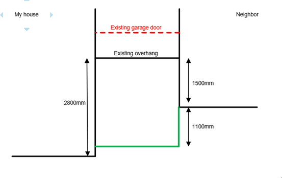

I want to extend my garage roof "only" forward to increase the overhang to give a larger covered area, and wonder if anyone can confirm if i need PP.
The existing garage door is shown on the diagram below by the red dotted line. The current up and over garage door will be replaced with a new standard door type and will remain in approx the same place.
The black horizontal line shows the existing roof/overhang position
I would like to extend it forward as depicted by the green solid lines
It will not extend past the front my my house (left) but will need to come forward 1100mm of my neighbors property
Out of courtesy, i will obviously be asking my neighbor for permission to fasten joists to his property, but can anyone confirm if officially, this needs PP please ?
Many thanks in advance
Apologies, forgot to add as i think the height is relevant also, the existing height of my flat roof is 2450mm

Assuming the garage was original (or was built under a previous planning permission) what you propose would need planning permission as it is an enlargement which extends beyond a wall forming a part of the original front elevation, the 'wall' in this case being the existing garage door.
If the garage was a later addition built under permitted development, the canopy/carport would be permitted development as long as its width was less than half the width of the orginal house.

The rule for enlargements at the front is that it is not permitted development if;
(e) the enlarged part of the dwellinghouse would extend beyond a wall which -
(i) forms the principal elevation of the original dwellinghouse; or
(ii) fronts a highway and forms a side elevation of the original dwellinghouse
By 'original dwellinghouse', they mean the house as originally built, or as it stood in July 1948 if it was built before then. Even if a wall (or in your case the garage door) is set behind the main front of the house, it is still regarded as forming part of the principal (ie front) elevation.
The fact that it is just a roof is irrelevent - so far as the rules are concerned, it is an 'enlargement'.
If there was no original side garage, then the rules for side extensions come into play, and you can extend up to the front of the house
without planning permission in that case, as long as the width of the extension is not more than half the width of the original house.
Seems crazy but them's the rules.

Finally, can anyone confirm what the trigger is and dictates the need for BC to get involved please ?
As this is effectively a car port, i *think* that it is exempt from BC, correct ?
A conservatory, porch, covered yard, covered way or carport open on at least two sides and less than 30 sq m is exempt from building control.
Thanks Tony !
Size will be approx 2.4m x 3.4m with 1.1m of the 3.4m being open on the neighbors side so assuming this qualifies, yes (not the entirety being required) ?
Common sense would assume so.
With it being relatively short, you could argue that it is not a true carport in that the average family car wouldn't fit entirely under it (eg if you extended it to say 5m to make it a true carport, the majority of the side would be open anyway).
It's down to how an inspector views it, but I suspect most would be realistic.
