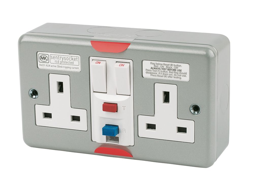

Actually, if he only wants one more socket, the simplest solution is just to add an RCD one.
Yes, I almost suggested that. However, although it's a means of achieving compliance with the regs, it seems 'silly' - if, for whatever reason, one is adding RCD protection, it would seem 'logical' to protect both of the sockets (and having a common RCD would be cheaper than changing both to RCD sockets).
However, I suppose you're right, if the OP is only concerned about compliance with regs, he could do as you suggest.
Kind Regards, John
Thanks John The whole thing seems like more hassle then it's worth all i wanted to do was put a treadmill in the garage. Now i'm needing electrician what a pain
You could theoretically do as BAS has just suggested and just add a socket as you have proposed, but use an RCD socket for the new one - the regulations do not require 'existing' sockets to be RCD protected.
However, unless 16A is enough for your requirements (and I don't think we've established that it necessarily is), you're going to have to get that B16 changed to a B20 - would you feel confident/competent enough to do that without an electrician?
