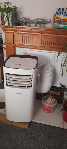

My vent must be around 20 foot at least, had the AC at least 3 years now,
once the chimney gets warm, thermals clearly help the hot air to rise, and it allows me to have all windows closed, been like that for at least 3 years, so assume chimney must be at least 20 foot tall. And it has worked great.
