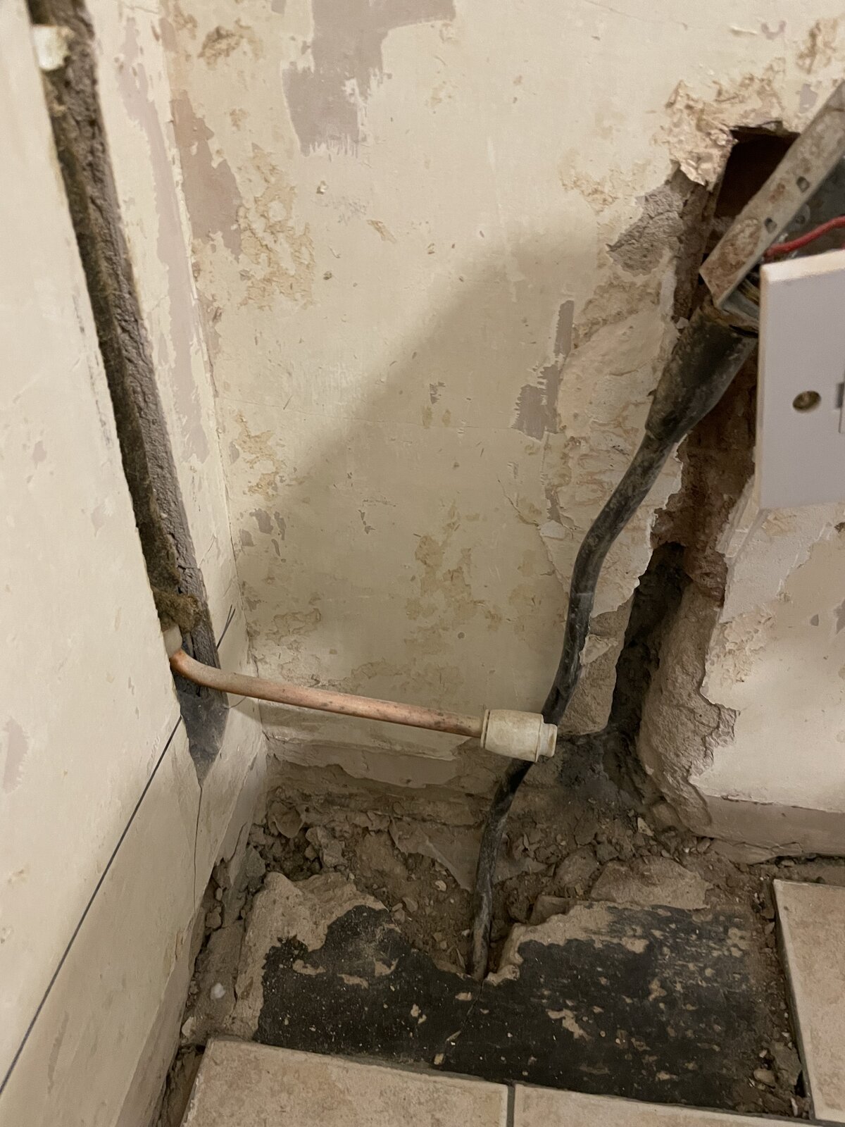

I’m going to have an internal wall removed and on this wall there is a fused connection to a SWA cable going to the garage
The cable is not long enough to allow me to take it to a different wal
Is there a way to extend it and leave the junction buried in screed?

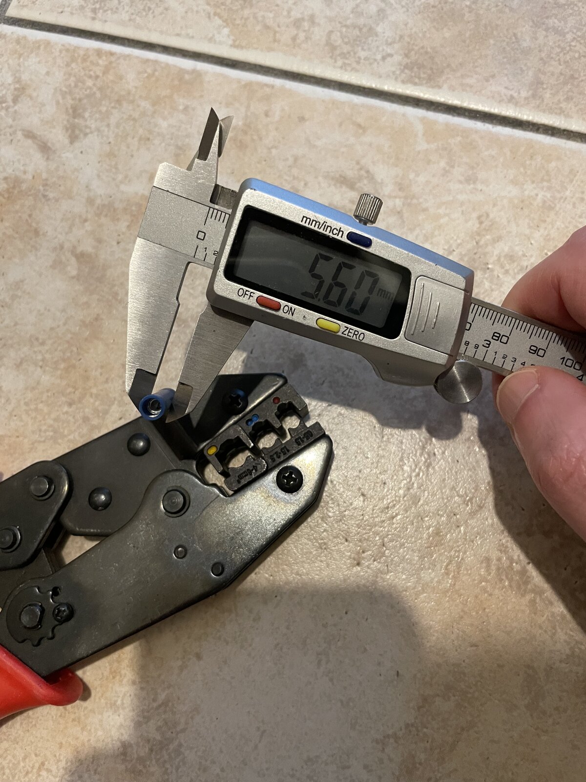

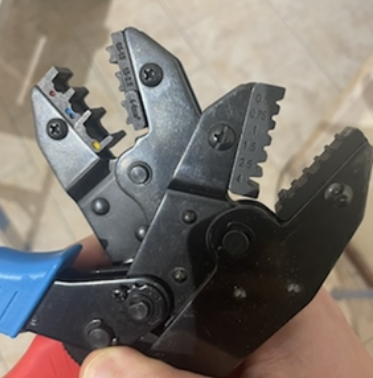

That’s exactly the product I ended up buying; I have a crimp tool so it shouldn’t be a problem
but is it the right tool for the crimps that you will be crimping ? There are dozens of different types of crimping tools for dozens of different types and sizes of crimps.
I think it’s the one on the left that I need, am I right?
Without knowing the size and type of crimp I cannot answer your question.
The connector is the insulated ‘splicing’ type where you insert one wire at each end
Blue connector in the blue marked jaw?
I have always struggled to find proper information on what kind of jaw goes with what crimp so it’s normally a trial and error for me
Same here, contacting the manufacturers doesn't always result in a clear cut answer.
But I think you are right about the crimp and tool combination.
