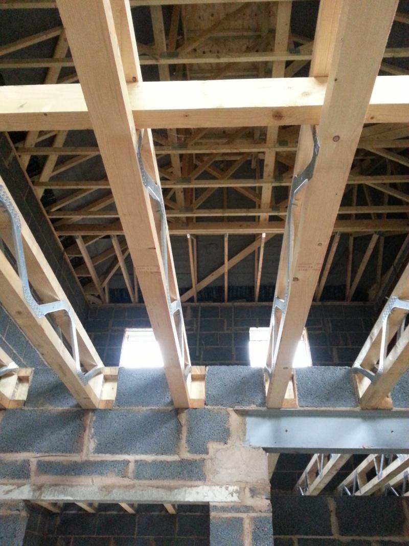

Yes me.
I've built hip roof extensions with flat tops on them in order to satisfy ridge height rules. They are...er...'fun' to build. You have to tile the structure then the flat roof guys apply the roof material and stick it down onto your lead flashing, on the run-off side. The other three sides to the flatty usually have a ridge tile.
Here's a piccie from the inside......

nothing is as simple as you first think, had to be like to comply with local planning rules so the extension looks like an extension
