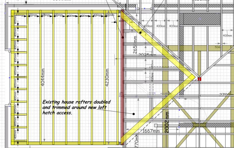

I am building a two storey extension on the side of my semi. I want to extend the roof across the new blockwork. My mate's house has had this done, but the builders left all the old hip timbers in and attached the new ridge board to the existing joint, is this the normal way? I assumed all the old hip timbers come out, the existing ridge timber gets temporarily propped and the new ridge timber gets scarf jointed to the old one or am I wrong?
The rafters are integral to the roof's strength. Remove them and you may need to consider alternative support and bracing to the existing roof or hips.
Was this not detailed in the plans?
It's not impossible to take these out. But it's easier to attach your new roof onto these rafters - ie layboards instead of cutting the new rafters to the existing hips.
If you think that you will be doing a loft conversion later, then plan for it now in how you join the new roof. Especially if there is a set back at the front and you need to insert a new valley rafter there.
If you have a set-back at the front, your new ridge will be lower and will reduce the scope for a loft conversion.
Also, the joiners will almost certainly use the existing side rafters for support anyway (via 'layboards' = pieces of board laid on top of the existing rafters to support the new rafters) so that will further scupper a loft.

As said, the simplest way to build onto an existing roof is via lay-boards. In order to do it in such a way that leaves a clear space within the loft, essentially means a roof re-build or as near as dammit.
I will not be doing a loft conversion (if you spend too much on a semi you will not get it back). Is a 'layboard' a length of 6 x 2 nailed up the existing rafters? or is it a bigger size?
6x1 or 9x1 or 2 4x1's etc. It depends how thick your new rafters are as once they are compound cut, the end cut can be quite long

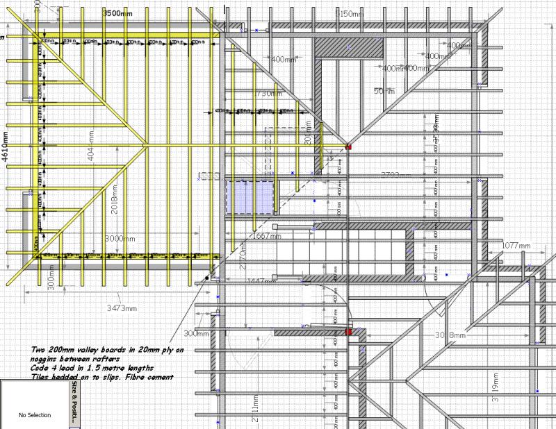

Take a look in my post history - I did a layboard roof extension to a 1930's semi and posted a fair number of drawings. Will have a look for you later.
First drawing is ceiling joist and layboard detail:
(as you can see above, all existing rafters were doubled up as per SE's advice)
Second drawing is rafter/ridge detail:
