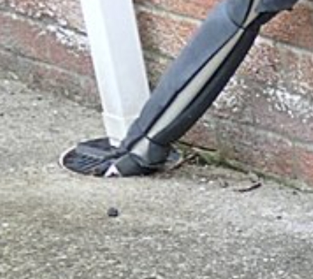

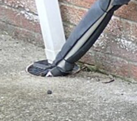

I'm in the process of purchasing a bungalow with an extension. The bungalow was built in 1975, the extension in 1994. I noticed a vertical crack in the render and in the brickwork below where the extension joins the main house. Difficult to say the width of the crack as small chunks of render have come off too, and the previous owners splodged random sealant into parts of it, but I'd say between 1mm and 4mm max.
Also, the extension floor is slightly uneven at the far end. I'd estimate only by 15mm max to min, but it's noticeable. I don't know what's underneath the boards. There are no internal cracks in the extension walls, not even hairline, so I'm wondering if it's a case of the extension being simply miserable and poorly constructed, or might there be something else to consider?
The bungalow as a whole needs a fair bit of work so moderate cost to fix wouldn't be an issue. Does anyone have an idea?
Thanks.
Thanks.

That's a difficult one. I'd want to look at the original building just to check that there are no major issues with that part first. The images you have shared of the extension tend to suggest that corners were cut. The bricks may be slightly different sizes, which might explain the bad toothing at the join, and that drain gulley (whatever it is) looks very suspect.
If the main building is sound, I'd be inclined to budget for the extension to be rebuilt.

I think that horrible pipe is the overflow from the boiler, which for reason I couldn't guess at was installed not in the utility room, but in the loft.
