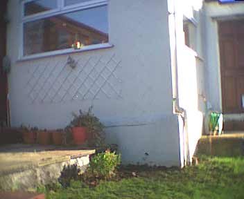

I have a single story extension at rear of my bungalow.
The floor level is about 2 ft above garden level.
However this 2 ft of foundation goes only about 6 inch below garden level.
Extension is about 20 years old . Is this acceptable.
Open link below for photo.
I wouldn't have thought so. Was it built with building control approval? I built a 10'x10' kitchen extension on my house in 1978, and even as long ago as that, the trenches had to go way below the house footing. In fact, just over a metre deep.
It's acceptable if it's been there for 20 years with no movement though? It could be a slab foundation reinforced with steel mesh?
i tend to agree that if it aint broke dont fix it! Many victorian houses are still standing even though they were built on minimal foundations. As shaggy said it could be a raft foundation, in which case all you would have would be a concrete apron at the edges of the slab

Has been built at least 15 years, maybe longer. Has a few hairline cracks to exterior.
No building control or planning permision.
Looks like its got apron.

Planning to build another extension to side of it. Worried this may affect its stability. Also worried what planning office will say.
