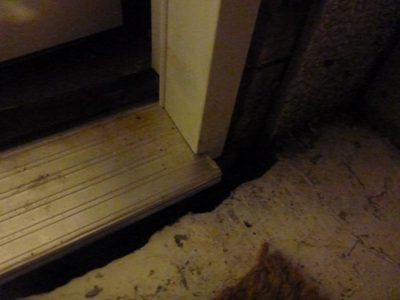

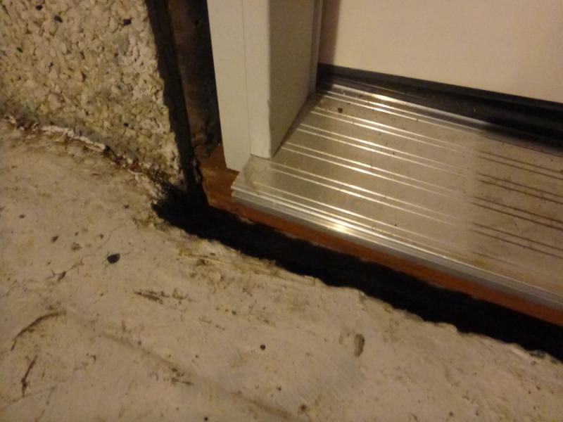

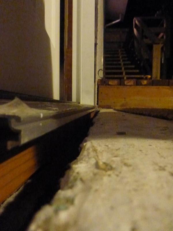

Recently have begun replacing an exterior door. The old door threshold was very rotten but also was set into the concrete slab outside the door. With the new door I have tried to raise it up so that the threshold would be level with the concrete, but this causes the problem that I now have a gap in the concrete right in front of the door. I am looking at ways to stop water from pooling into this gap and then going into the house.

Fill the gap up with fresh concrete (the patching type that you can buy ready mixed as powder is fine) and give it a slight slope so that it casts the water away from the step.
John :)
as above but id also be inclined to either treat or paint the threshold to protect it prior to covering it up.
