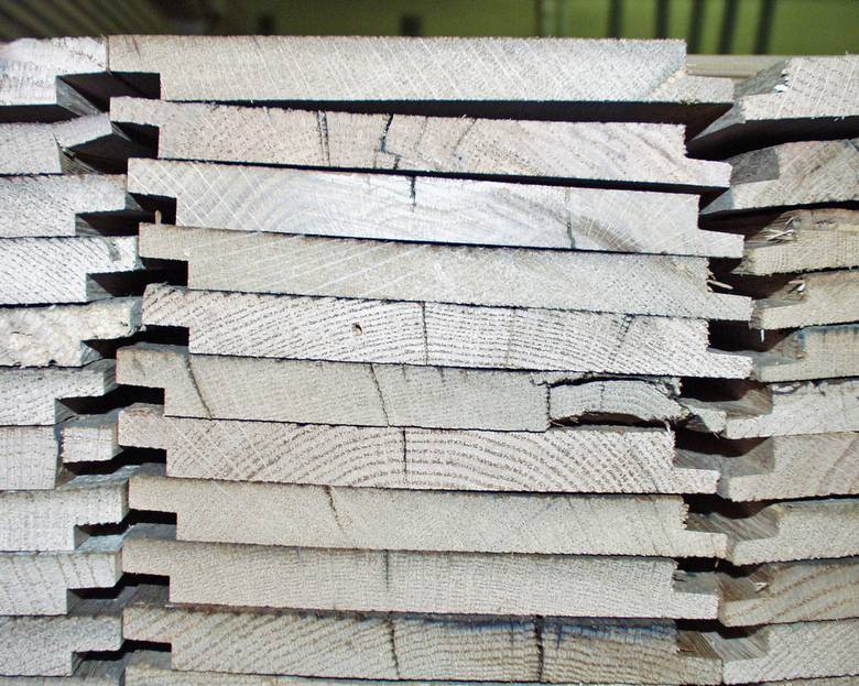

First post so go easy on me :)
Long story short, I'm looking to build my own shed and want to save money in the process. My thought/plan is to purchase wood like this and then use the router to cut them like the attached image. Is this wood suitable (once treated) ?
Time isn't a problem as I already have a shed but it's getting old now.

Personally I'd go for ready tanalised timber, but there's nothing wrong with your proposal......always best to buy timber from a genuine timber merchant if you want quality stuff!
A tongue and grooved moulding would prevent warping better.
John :)
As John say, make it out of tanalised, and have a shop around the local timber merchants see what they have on offer.
You can extend a shed, but you need to put some sort of frame in to strengthen the area where the join is, as taking the end away weakens the structure.
Feather edge is about a quid per length.
