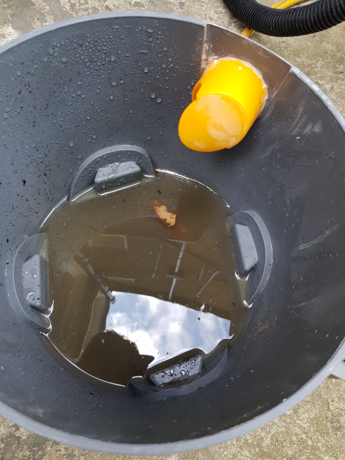

Well the plot thickens, or rather the water deepens.
After having removed all Standing water from the main rainwater gulley drain yesterday afternoon, this morning the drain had about 12cm of water in it. I don’t think it rained overnight here, and my other rainwater gulley drain didn’t have much water in it, although Admittedly that’s a smaller roof section. I’ve wet vac’d it empty again and will see if it fills - this is how much came out overnight
water may be gettin IN through the crack today.
OK @JohnD, my theory right now is looking like there is a leak or leaks somewhere that have been going on for over a decade. This caused damp issue pre-2010 whereby in 2010 the previous owner got Kenwood In to do a bunch of, presumably expensive, damp proofing works including the cement plinth, cement pad around the main rainwater gulley and manhole, air bricks, tanking the works. This then stopped the damp entering the building but did nothing to address the source of the moisture which continues to this day, manifesting in damp earth along the boundary and very high persistent humidity levels in the building.
I have some drain rods en route and I also have a 5m endoscope already in my possession. Next step is DIY drain inspection for cracks or leaks.

your next step should be trying to find out where the water is coming from.
you wont necessarily have a crack or break in the drain.
a large leak from a feed /main will find it’s way into the drain regardless.
