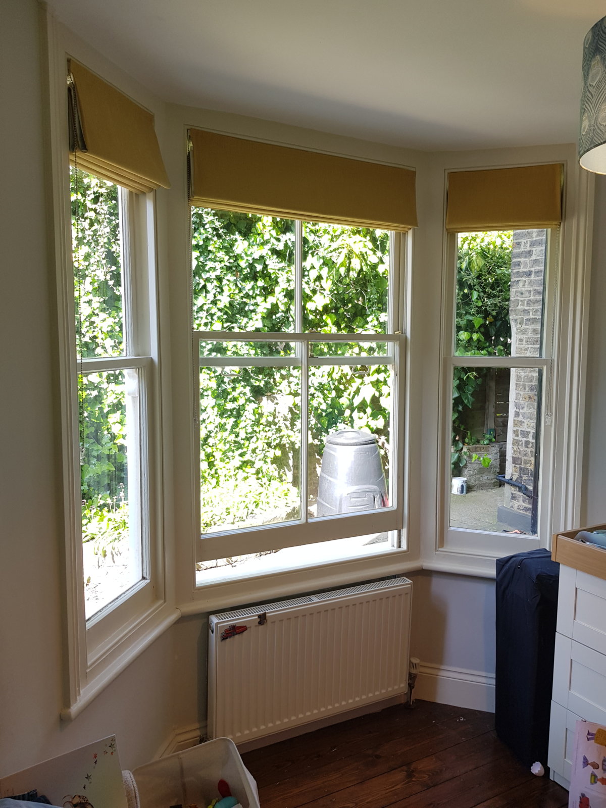

I re-iterate, a photo of the inside of the bay window would be helpful.
Here it is. And the wall thickness is approx 270mm at the bricks (excl any sills, cement ledge etc)
