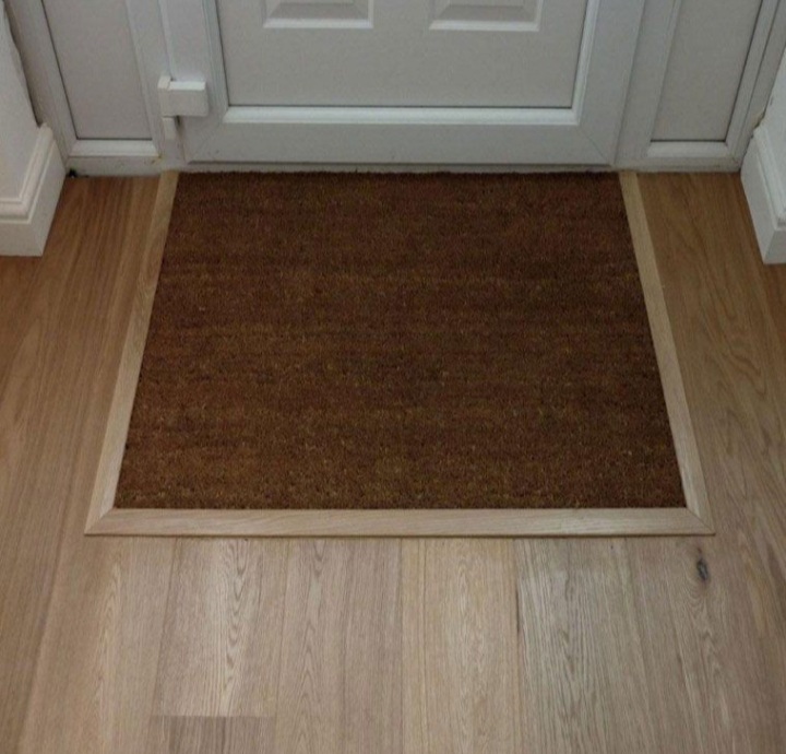

One possibility...
Install the floor first, but leave a gap to the door to install a recessed Coir Mat - something like this (plenty of examples online)
and then install the new door at your leisure; building up the depth under the mat to the desired level.
