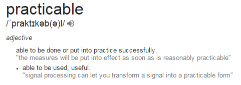

Not really, The regulations state that it shall be bonded at point of entry where practicable - not practical.

My question was more out of surprise rather than seeking a realistic alternative solution. 'Practicable' seems to be a mix of 'practical' and 'possible'. Something being a P.I.T.A. is no excuse, it seems. I should resign myself to my original wiring plans, and the consequent discomfort in sitting comfortably!
