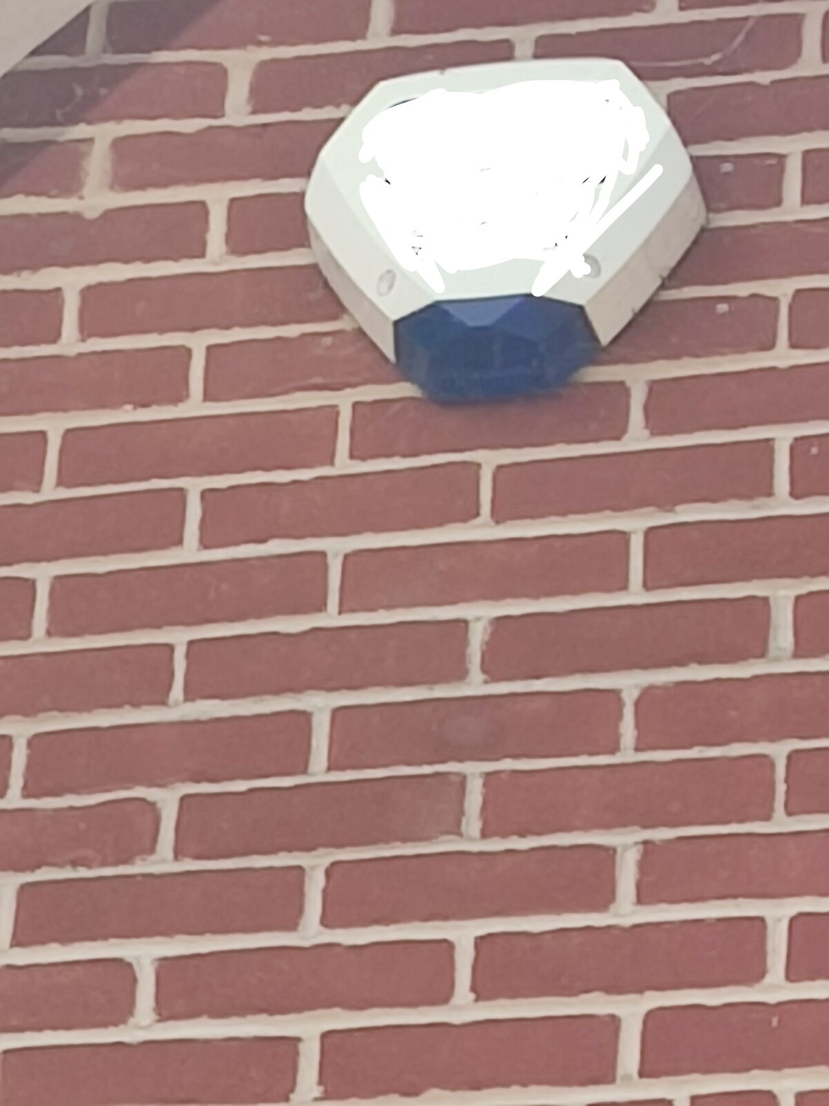

External siren - can it be modified to be turned off manually from inside?
23 Nov 2012
23
Essex
I hope I can explain this sufficiently as I'm not very technical...
We have an i-on30EXD alarm system - pretty standard stuff, keypad in the hallway, sensors in the rooms, some kind of internal siren somewhere, and a big much noisier external siren positioned near the roof, so accessible only by a big ladder. If I call the install company to come and do a service, is there any way that they will also be able to install a manual shut off for that external alarm, ideally wired into the bedroom that it sits outside?
You may wonder why we want this - well about 7 years ago our external siren had a malfunction of some kind, and upset the neighborhood for several hours before the insall company were able to come round and fix it. I think they replaced it, I can't remember exactly - but nevertheless, I'm conscious that if that ever happened again, especially if it was at night, that would be extremely annoying, so if I could have some kind of manual override in the bedroom the other side of that external wall, then I could avoid that ever happening again. I don't think it would be compromising our security in any way - someone would need to set off the alarm in order to get into that bedroom, and would have to know that there was a manual shut off and where it was etc.
I know some may say 'ask the installer', but I'd like to get any idea from anyone knowledgeable on here if possible, in case the installer tries to fob me off, or in case there are particular questions that I should ask them etc.
TIA :)

Most modern bell boxes have a 15/20 cut off timer built in so it’s not an issue

IF there is no timer for it and it does not have an internal battery then you can get a keyswitch fitted in the supply to it.
Or even if there is an internal battery a relay can be fitted inside it to disable both supplies and operated by a keyswitch.
That would allow the keyholder only to disable the external sounder should a fault occur again.

Only way to stop a sounder from sounding is to break the power to the sounder(piezo).
So your running a cable to the piezo with a secure switch inline so you could turn it off and on no matter if the panel is trying to activate or the bell self activating it can be turned off.

If you pull 12V from the bell box then it should go off until cut off expires, however it can continue under some circumstances intermittantly until the bell boxes battery dies. So it technically hasn’t been running continuously longer than the cut off timer of 15/20minutes. But has been ringing over 15/20 minutes in an hour.
I had a fault that caused mine to sound repeatedly. The siren had the usual 20 minute cut off but kept getting triggered. Annoying the neighbours until the mender could come.
So I pulled the fuse from the panel power supply and eventually the battery ran down.
AFAIK it is quite unusual to have the 20 minute cutoff fail like that.
