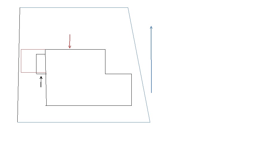

I've tried to include a rough outline to help show what I am talking about. The blue outline is the property boundary. The black outline is the existing property and the red outline is the proposed extension (for which permission has already been granted). For extra clarity, the blue arrow is the direction of the downward slope of the hill, the black arrow is the location of the existing exit (to be retained) and the red arrow is the location of the new exit into the back garden, that I am hoping to get stairs up to. The drop from internal floor height to ground level at this point is about 1.6m.
wouldn't that count as a raised platform and thus require planning?
