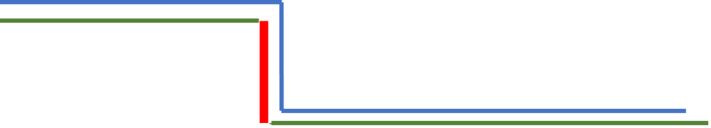

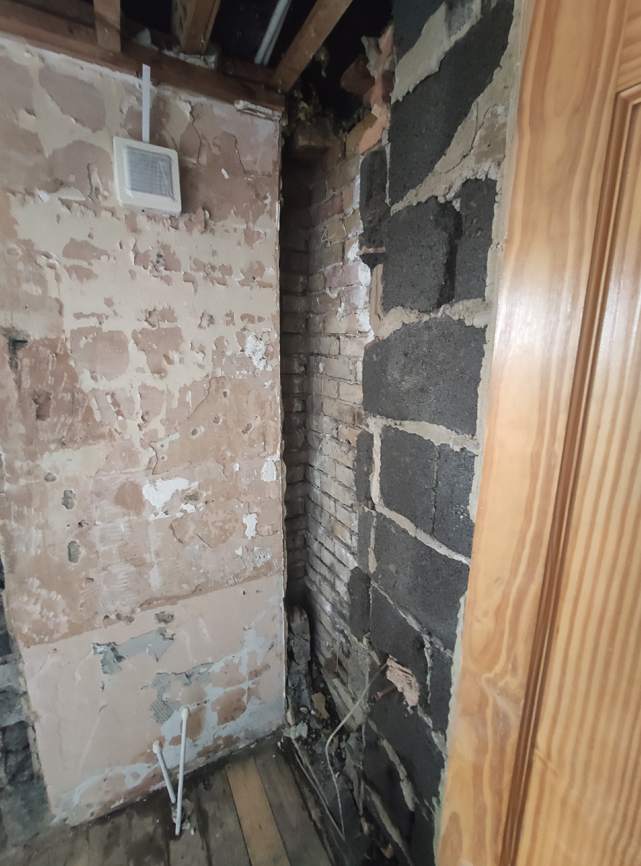

There is a wall that had a weird shape and the builder asked me if I wanted to have it flat. I told him that, if the wall was non-load bearing, then yes. If it was load bearing, absolutely not. I left him in the room and after a while he came down saying that he had proceeded to eliminate this weird shape. After a while I went back up and, to my horror, I realized that what he had taken out was actually the blockwork of the external wall. Please see images below:
In blue is the external brick wall.
In green is the internal blockwork. What they have done is they have removed the RED blockwork. It's about 40 centimeters in total in length.
To me, this seems like a massive problem. Am I wrong? What should I do?
Above there's the roof and there does not seems to be structural elements that lay in this stretch.
I've pointed this out to the builder. He said that tomorrow he will fix it. He did not seem to make much of it but I am kind of freaking out :eek:. Am I making a big thing out of nothing or is this indeed a huge mess? What should be done to fix this? I want to be sure I don't end up with structural problems, cracks and so on :oops:
Not sure what he was trying to do. Looks like a fair bit has gone down the cavity.
yeah... that also.
How bad is this? What do I risk here and what should I do now? He said he's going to fix this tomorrow but at this point I don't trust the situation too much. I don't want this to be fixed in a ****ty way that will come back to haunt me in a few year's time...
I suspect he does not know what he is doing, so it's difficult for anyone else to know what he was doing either.
Yes it's a potential structural issue, damp issue and insulation issue. Each will need addressing.

Well, yeah, I thought as much but my question is: what do I do now? He said tomorrow he will fix it but now I am concerned regarding what he'll actually do to fix it. If he just puts some blocks back and essentially goes back to the original situation, will that be sorted (not the damp part of course)

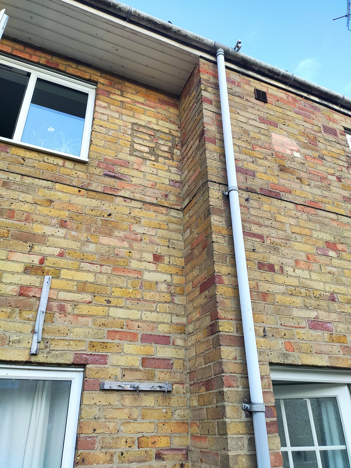

Have you got a photo of the outside where that dogleg is?
there you go
The part that has been removed is the corner at the first floor, under that under that sort of overhang
I can see what he was trying to do now, but was totally wrong. The cavity needs cleaning out and the blockwork rebuilt to how it was.
So, if he just just reconstructs the cavity by placing new blocks, from a structural perspective, everything should be fine?

If the wall is put back, it needs to be put back properly - tied in to the surrounding walls properly, the wall above packed properly, tied to the outer wall with steel ties, the cavity thoroughly cleaned out of all debris, and not a load more debris dropped in when he's rebuilding it!
