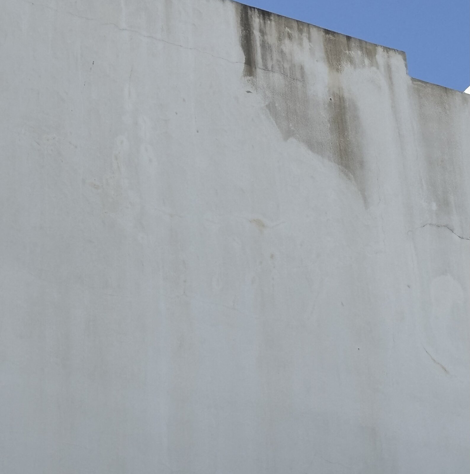

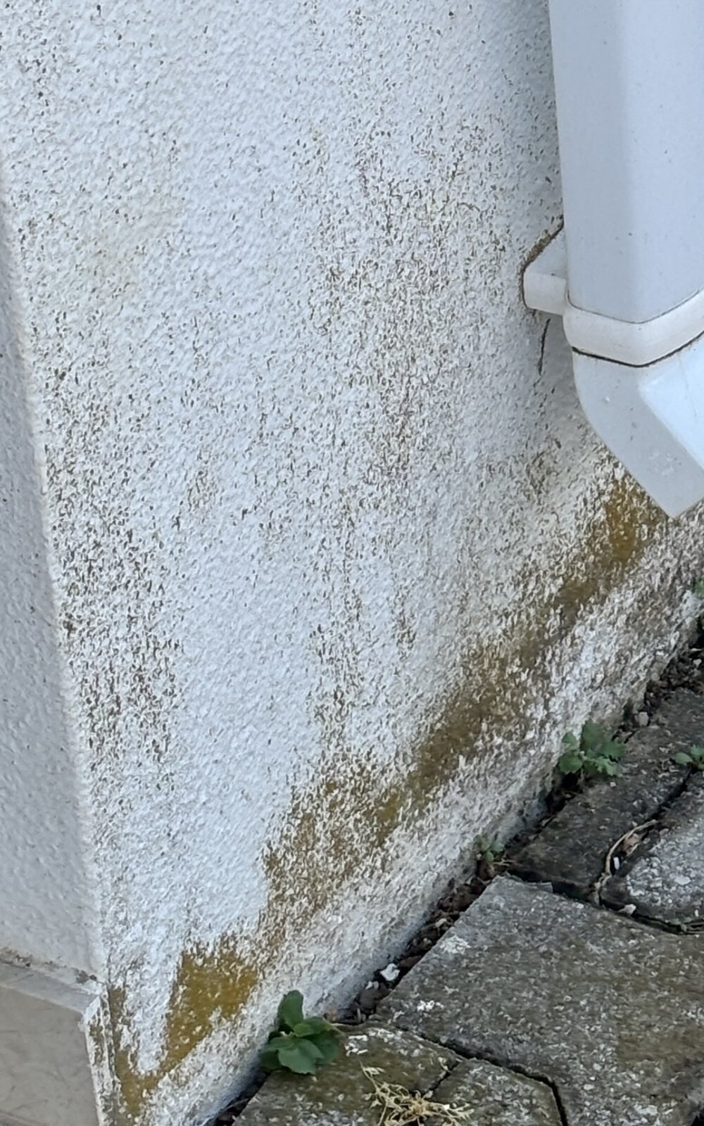

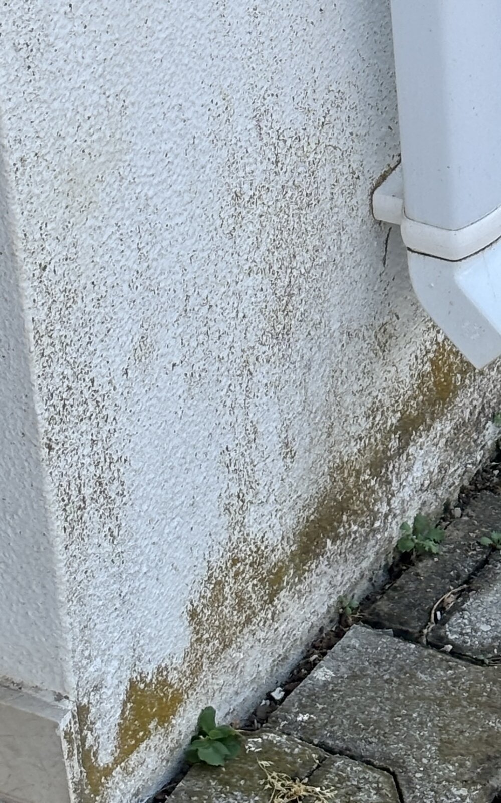

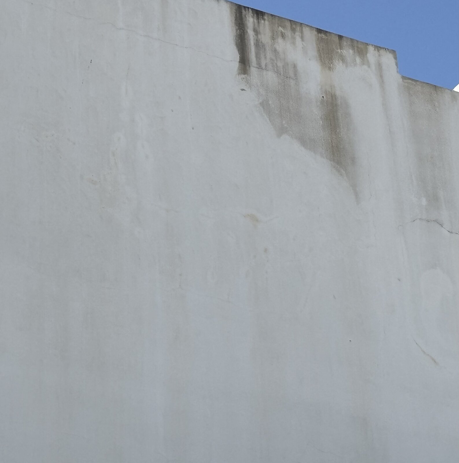

Here are a couple of photos. Most of the walls had green and black patches of algae/fungus which appeared within a year or so after the last repaint and gradually got worse, which is why the walls were supposed to have been treated with a fungicide after pressure washing this time around.
These photos show parts of the rendered walls after pressure washing and before they were primed and painted. I havent included photos of the finished job because visually it looks ok at the moment, but can do if needed.

I just wanted to follow up if anyone had the chance to check the photos out and provide an opinion?
Thanks!
Well, the first picture doesn't look clean enough to paint or prime.
The second picture, they presumably couldn't reach that last bit to clean.
