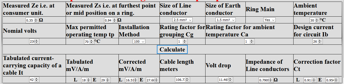

As said the 100 m² is a guide to help not have too much volt drop or loop impedance the latter is to ensure the magnetic part of the MCB will work, or a fuse will rupture in time with a direct short circuit.
I a long time ago wrote myself a java script program so I could enter the readings to ensure I had not exceeded the limits.
However when I came to use the program I found the accuracy of the loop impedance meter and the fact that the design current is not really fixed, means that one would have to be well over the limits before one could really take an electrician to task for going over the limits. Readings shown is what is claimed it the maximum length of a ring final. They assume 20 amp at centre and 12 amp even spread, so average of 26 amp. I am sure you can see flaw in that.
About the only item today which may have problems with volt drop is refrigeration, the motor needs to reach speed before the pressure raises too much or it will stall, and the overload will trip and once cool it will try again, if the volt drop is too much then the overload with repeated use will fail, I did see a few AC units fail this way, but the voltage was way under the design voltage, looking at less than 200 volt for a 220 volt unit. The other is fluorescent lights not striking, but most other stuff used today will take quite a volt drop, so no longer important.
The other is the tripping of the MCB or rupturing of a fuse with direct short, in the main worried about short to earth, but with RCD protection the RCD will open even if the earth loop impedance is well over the permitted level for the MCB/fuse, so although we should work out the earth loop impedance in real terms it is unlikely to cause a problem if high.
Note DC it is called resistance and AC called impedance, both measured in ohms, so although not strictly true you can regard them as the same. So just do it.

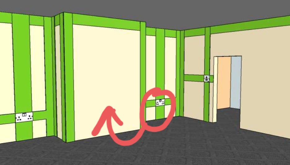

Whilst I have some knowledgeable folk here, could I ask another question:
I want to spur one socket onto my chimney breast, the depth of this is around 250mm, could I run a socket from a wall next to this to the front of the chimney breast? Technically the sides are slim enough so that the safe zones cross over and the front would be covered with the new socket showing cables could be either side..
I've attached a photo to show where I mean.
Thanks again
I would say that your interpretation of the rules is probably strictly correct.

I think the only issue is probably that, as I said, it is 'not ideal' - since, although it is 'technically correct' (and hence 'compliant with regs), I would not like to guarantee that others (with drills in their hands!) would necessarily 'twig' that the two overlapping 'safe zones' (I tend to call them 'dangerous zones' :) ) rendered the entire side of the chimney breast a 'safe zone'!
The new cable would, of course, need to be RCD-protected in order to be compliant.

Hi John,
My consumer unit has RCD protection built in, does this cover the new socket?
I don't plan on moving any time soon but I can label up the back box to ensure any future occupiers can find where it is cabled to, I measured just now and it's actually only 143mm deep (Not sure why I had 250 in my head!) So the whole wall is classed as a safe zone anyway
Fair enough.
