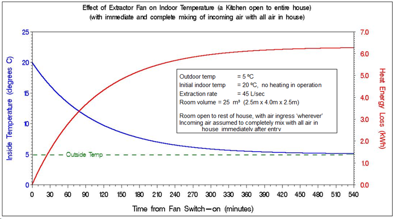

I have considered two rooms with extractors. Firstly a 2.5m x 2.5m x 2.5m kitchen with an extraction rate of 15 mL/sec (minimum recommended by App Doc F) and a 2.5m x 4m x 2.5m kitchen, with an extraction rate of 45 L/sec (mid-range of App Doc F minimum recommendation).
For both rooms, I have considered two scenarios, at the 'extremes'. Firstly a fairly unrealistic case of the room being 'sealed' from the rest of the building, with a ventilator within the room to outside air. Secondly, at the other extreme, a situation in which the room with the extractor is completely open to the rest of the building, such that (per the/your assumption) incoming outside air was rapidly and completely mixed with (hence 'diluted by') all of the heated air within the building. For the latter, I have assumed a total house volume of 280 m³.
In all cases I have assumed an outside air temp of 5 °C and an indoor temp of 20 °C when the extractor was first switched on. I have also assumed there is no heating in operation within the building and that, in the initial state, the entirety of air in the building is at the same temp. I have also assumed that the extraction is continuous for the periods I have indicated.
The results of my simulations are shown in the graphs below, which are hopefully fairly self-explanatory, so I will provide only minimal description/commentary, an almost no 'comment'. In general, the graphs show the period up to when the indoor temperature (of room or whole house) falls to, or near to, the outside air temperature.
In the (fairly unrealistic) scenario of a bathroom or kitchen totally 'sealed' from the rest of the house, with its own ventilation to outside air, following switching on of the extractor, the temperature of air in the room fairly rapidly falls to the outside sir temperature. However, once that has happened there will have been only a very modest loss of heat energy, because there is relatively little air in the room, hence relatively little heated air mixing with, and 'diluting', the incoming cold air (or vice versa).
In contrast, when the room with the extractor is open to the whole of the building, a very much larger volume of heated air is involved, and if one assumes that the incoming cold air rapidly and completely mixes with (hence is 'diluted by') all of that heated air, the fall in indoor temperature (now of the whole house, because of the assumed 'mixing') is considerably lower, but the loss of heat energy is considerably greater. By the time the indoor temperature has fallen to close to the outdoor temperature, about 6 kWh of heat energy has been lost - so that is roughly the amount of energy (gas, electricity, oil or whatever) that would be required to restore the indoor temperature to its original level.
The real-world situation will be somewhere between the two extreme scenarios depicted below, depending primarily on the locations of air ingress points relative to the extractor and the speed at which mixing/'dilution' of incoming and indoor air actually occurs.

Exactly. My second pair of simulations (with bathroom/kitchen 'open to house') made absolutely no assumptions about where (or in how many places) the replacement air was entering the house - only that, as you believe, that once it entered (wherever, and through any number of routes) it was immediately and completely 'diluted' by the air within the house.
To suck even 50% of the heat of a home out, would need a massive amount of through air flow, and that air flow would only manage to cool the air immediately,
If there were NO mixing/dilution (i.e. the entering cold air simply 'followed behind' the heated air which was moving towards the extractor}, then to completely remove all of the (heated) air within a house of, say, 280m³ volume would only require 280m³ or so to be extracted, since all of the extracted air would be 'heated air' before any of the replacement cold air got to the extractor. However, if mixing/dilution does occur, then much more has to be extracted before 'all the heated air has been removed', since the extracted heater air is progressively diluted by the cold replacement air that has entered.
Looking at my figures. in the case of the kitchen 'open to the house', it takes about 8 hours (at 45 L/sec extraction) for all of the heated air to be removed (i.e. for indoor temp to get close to outdoor temp) - so involves the extraction of about 1,296 m³ of air from the house . That is some 4.6 times the total volume of air in the house and, as above, that is because, as you acknowledge, the heated air is progressively more and more diluted by the cold replacement air.
However, interesting though it is to look at how long it takes to extract almost all of the heated air (hence energy), people are rarely going to leave extractor fans on for that long, so it is of little more than theoretical interest, much more important being what happens in the much shorter-term real-world situation. If you look at the last of my simulation graphs (kitchen 'open to house') you will see that about 1.5 kWh of energy is lost during the first 30 mins of extraction, and nearly 3 kWh is lost during the first 60 minutes - amounts which are 'not insignificant' at current energy prices.
