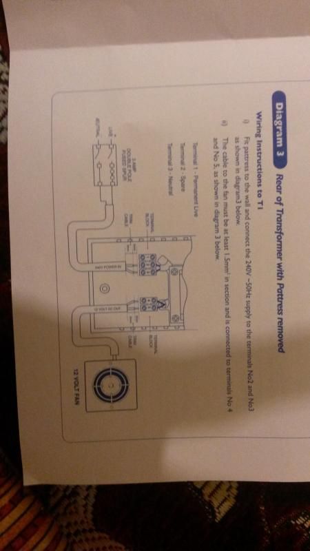

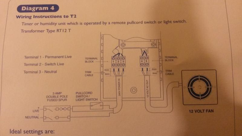

I have a feeling L2 comes into play,I have wired up my fan as in Dig 1. But would like to wire it up to Dig 4, which cable from the rose L1 or common? Or do I use L2 and put it in terminal 2?
Sorry. I do not understand
You say Dig 1 and 4 but you have posted digs 3 and 4.
Also i do not understand the references to common L1 and L2. Tose are switch terminal markings. The ceiling rose will have loop N and L.
Post photos on here of the diagrams you are really talking about and also a pic of the ceiling rose.
It would be a great help if you could post the pics using the forum guideline so we can see the pictures in your post.
Here's how //www.diynot.com/forums/viewtopic.php?t=129539
There are many ways to wire an extractor fan which depend on where supplied from and type of fan and if there are windows and if those windows open.
When not required by building regulations running off the lights is common and in the ceiling rose you have a triple connector block plus earth and it is simply the double outside terminals to terminal 2 switched line, the triple centre terminals to terminal 1 permanent line, and the triple outside terminals to terminal 3 neutral. This of course will only work with fans designed to run on be it simple timer or humidity controlled.

Your problem is that you will need a neutral connection to the fan(whichever diagram you wire to).
It is extremely unlikely that there is a neutral at the pull switch. The place you will probably need to wire from is the light fitting oitself. It depends on how that is connected up, but you should find live, neutral, switched live and earth at the one place. Assuming you have a loop-in wiring at the light fitting.
Post a pic of your light fitting wiring if you are not sure.
