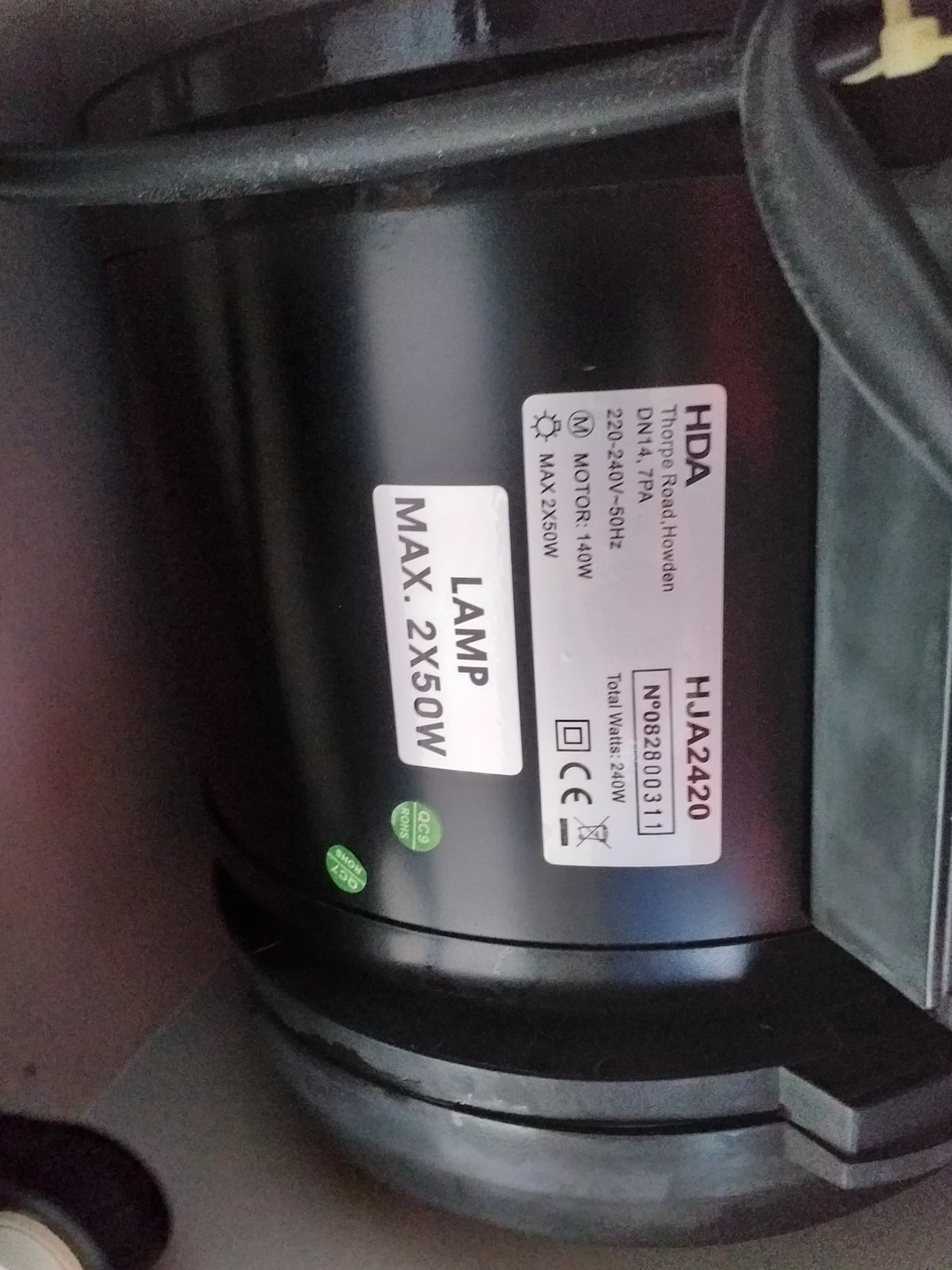

The fan motors usually include an internal fusible thermal link, inside the motor windings. Idea is, if the motor seizes up, they will over heat and the fuse link will fail. They are not repairable. I suspect the light failure is probably a separate issue.

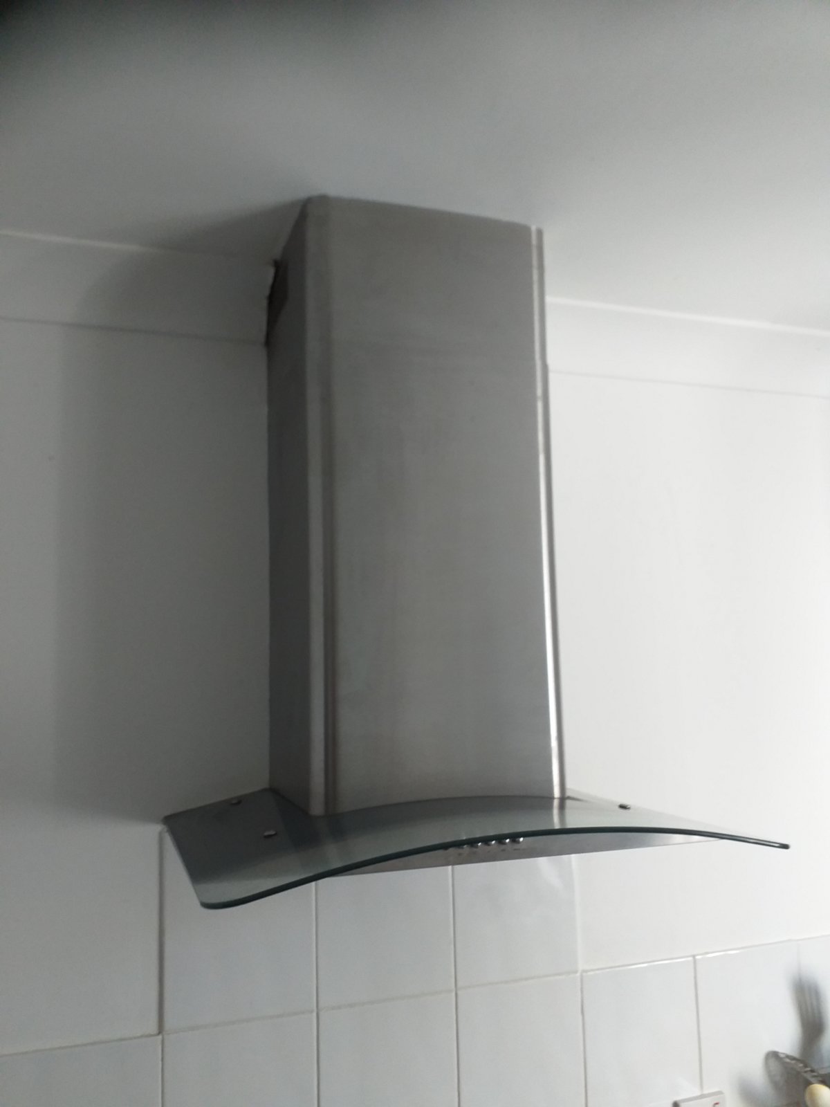

Cant find a name on outside, but says HDA on inside label as in picture. Does it have to be same model or will anyone do from b and q.
Photo of outside too
does it have an extractor duct through the wall or ceiling? older ones were often 100mm but they're now usually 125mm or 150mm

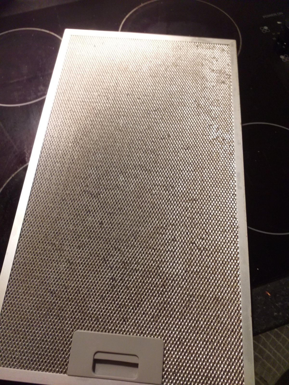

If the filters were clogged that might have caused overheating
look at your motor casing in case there is a red reset button on it.

From photo it looks like they go through ceiling. Where are the filters?
It’s originally Howdens supplied unit , plenty of spares online or you could replace with similar , does not need to be the same .
