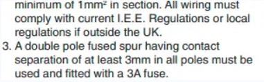

Good point/question. From a typical Manrose Installation Guide ...
.... although the document is only in English, the preceding instruction (as seen above) indicates that they acknowledge that the fan might be installed 'outside the UK (where they seem to think that "the I.E.E' exists :-) ), they still 'require a 3A fuse. I wonder how someone outside of the UK is expected to implement that 'requirement'?
Returning to all the fuss about failures to fully comply with MIs "invalidating warranties", what about 'requirements of MIs" such as these (again, from Manrose MIs ...

All wiring to be in accordance with the current I.E.E. Regulations, or the appropriate standards of your country and MUST be installed by a suitably qualified person.

I disagree with your reading of this.
You seem to be omitting the full stop, and new paragraph number 3.
Would this be clearer?

.... although the document is only in English, the preceding instruction (as seen above) indicates that they acknowledge that the fan might be installed 'outside the UK (where they seem to think that "the I.E.E' exists :) ),
It hasn't existed here for 17 years.
They can't. Which just proves that the maker is utterly clueless.

To my mind those are falsehoods which are egregious enough to be classed as lies, and therefore, in an ideal world, would see the directors of Manrose facing prison sentences.
And yes, I really do mean that.
