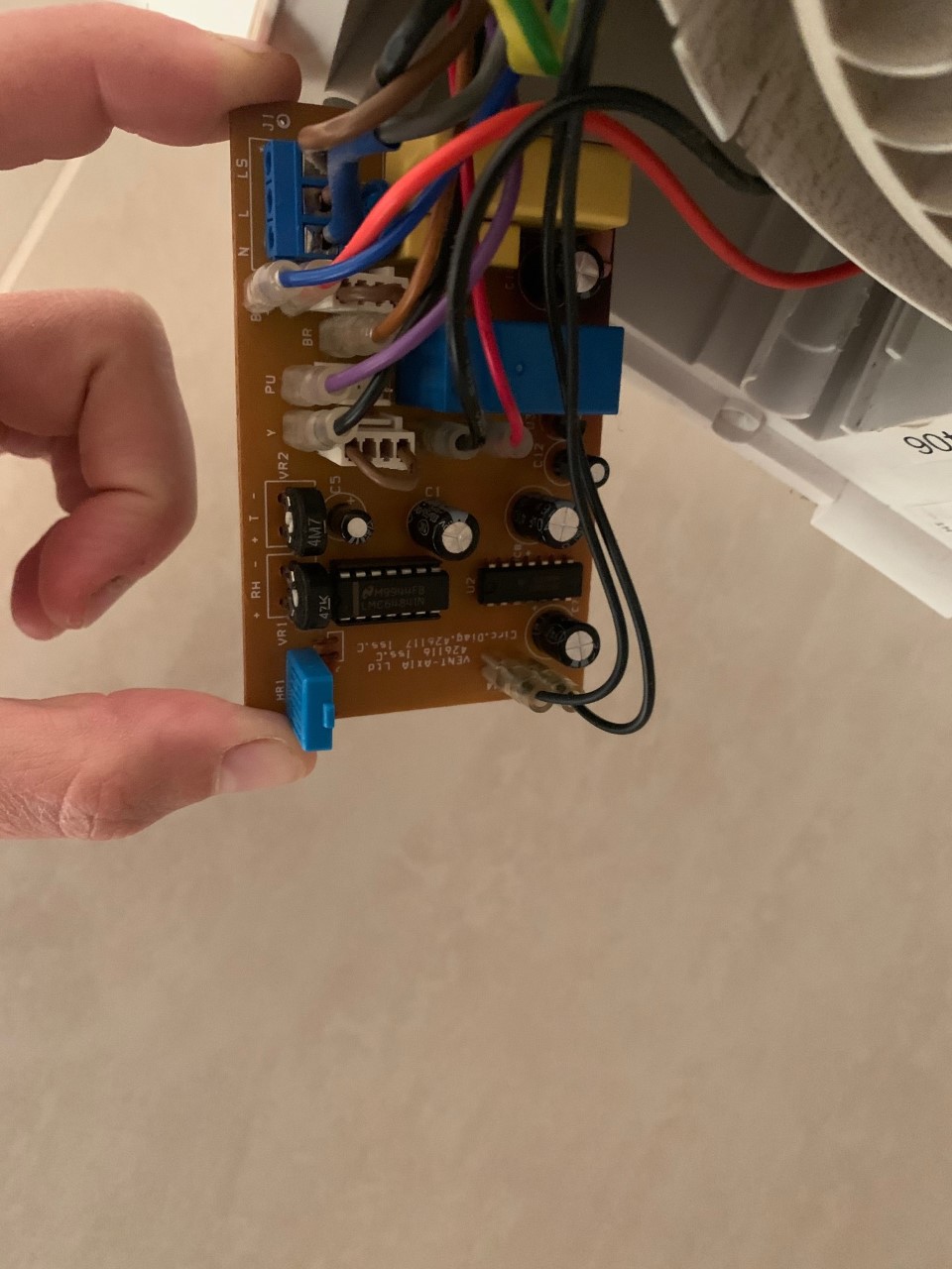

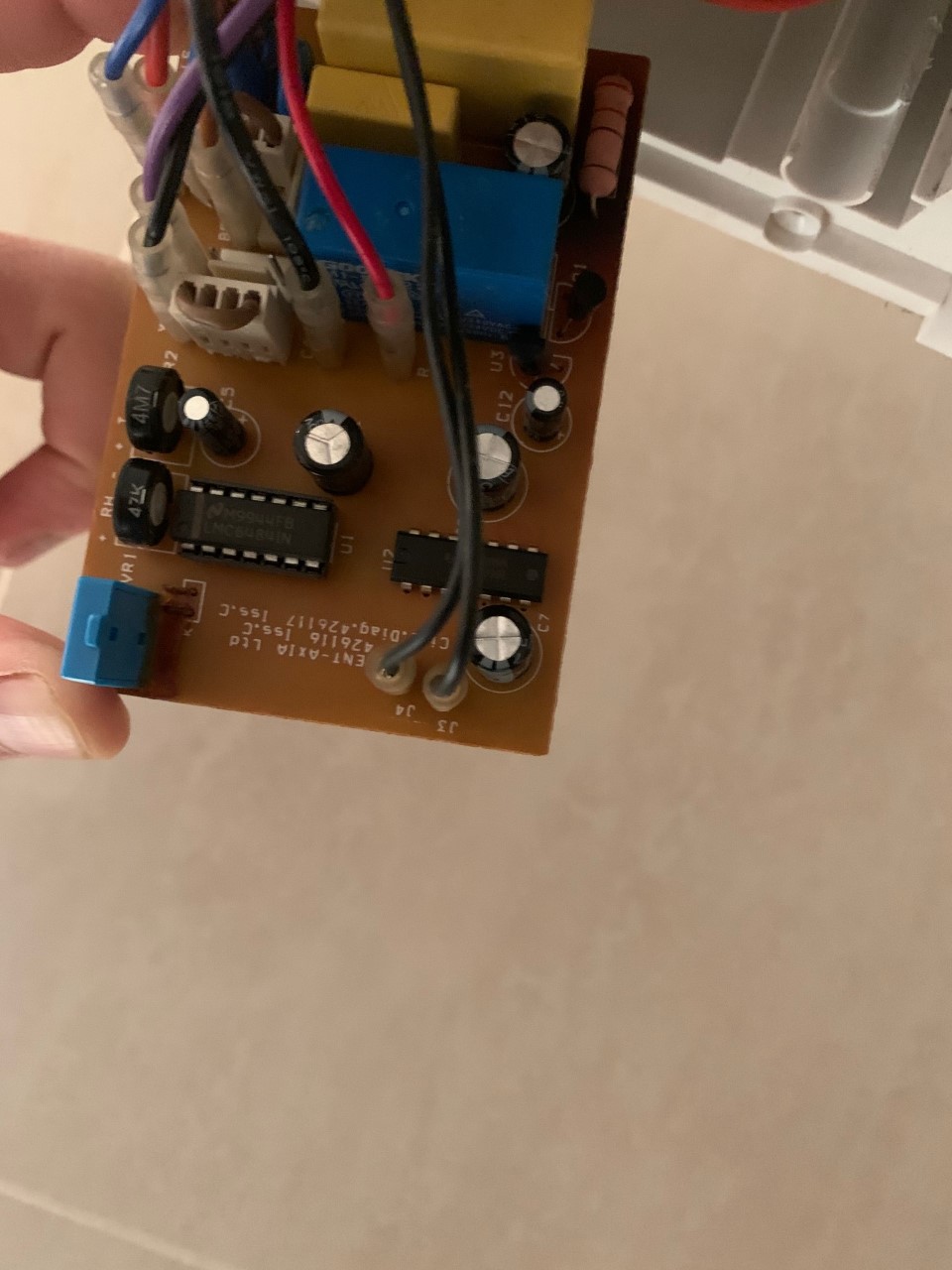

I don't have a multimeter but can get one tomorrow if I know what to check for. I wonder if it is the humidity meter that is busted and I might be able to bypass it. I've attached photos of the circuit board in case you might be able to advise on what I should be testing with the multi-meter (not neon screwdriver, as I've learnt from other posts!!).

there is a faint chance that the adjustment pots of RH and Time Delay have failed, so you could try wiggling them and setting to min and max respectively.
I think I can see the red and black wires that go to the fan motor. If you can identify the brown and blue (or red and black) incoming wires that beome live when the light is turned on, you could bypass the control circuits and just have the light switch turn it on. If you have energy-saving or LED lamps, the cost in electricity will be trivial, even if you leave it running all day.
Linking will tell you if it's the motor failed, or the control circuit (IMO more probable).
It would be useful, if you can take the whole fan down, to see the size of the hole, and the position of the hose. Most likely a similar fan from the same maker will have the same dimensions, but as I said, I wouldn't bother with a humidstat, I'd go straight to a timer model.

if it's a DC motor and/or low voltage then I would be standing well back.
I don’t see enough components there for it to be anything other than a mains motor; I think the blue box is just a relay. But better safe than sorry in any case.
It may be possible to hear the relay operating.
There are of course lots of things you could check with a meter; one thing I’ll just note now because I’ve looked it up is that the power pins to the LMC68641N quad op-amp are the middle pins on each side; you should get a modest DC voltage (less than 16V) across them whenever the perm live is on.
You obviously need to take great care when poking around in something like this with power connected. Don’t do it without someone nearby.
With power off, use the multimeter on continuity/low ohms setting and measure across the two wires that go to the motor.
If there is a low reading, motor probably ok. If it's open circuit, then the motor has failed (probably the thermal cutout inside).
