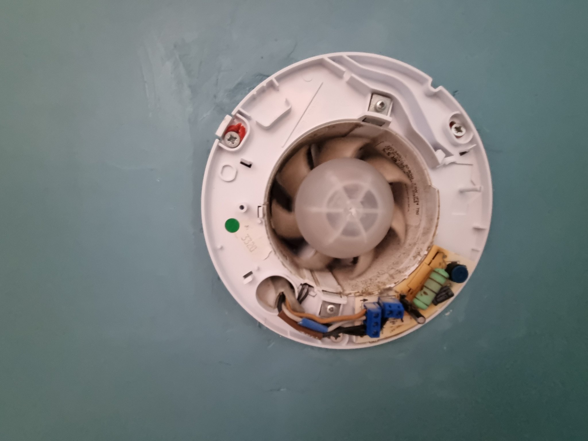

Hi all, I'm having trouble with my extractor fan. The speed is very slow at around 1rpm. I've tried changing the speed setting and as you can see not much dust. This is an Xpelair timed device.
Anyone got any ideas?

Does it spin freely, when turned by hand?
I am not seeing any speed control, just perhaps a run timer.
As above, replace it.
Looking at the printed circuit board, the discolouration would suggest that something has overheated.
There’s a huge resistor right next to the brown spot, so that might be normal heat dissipation.
