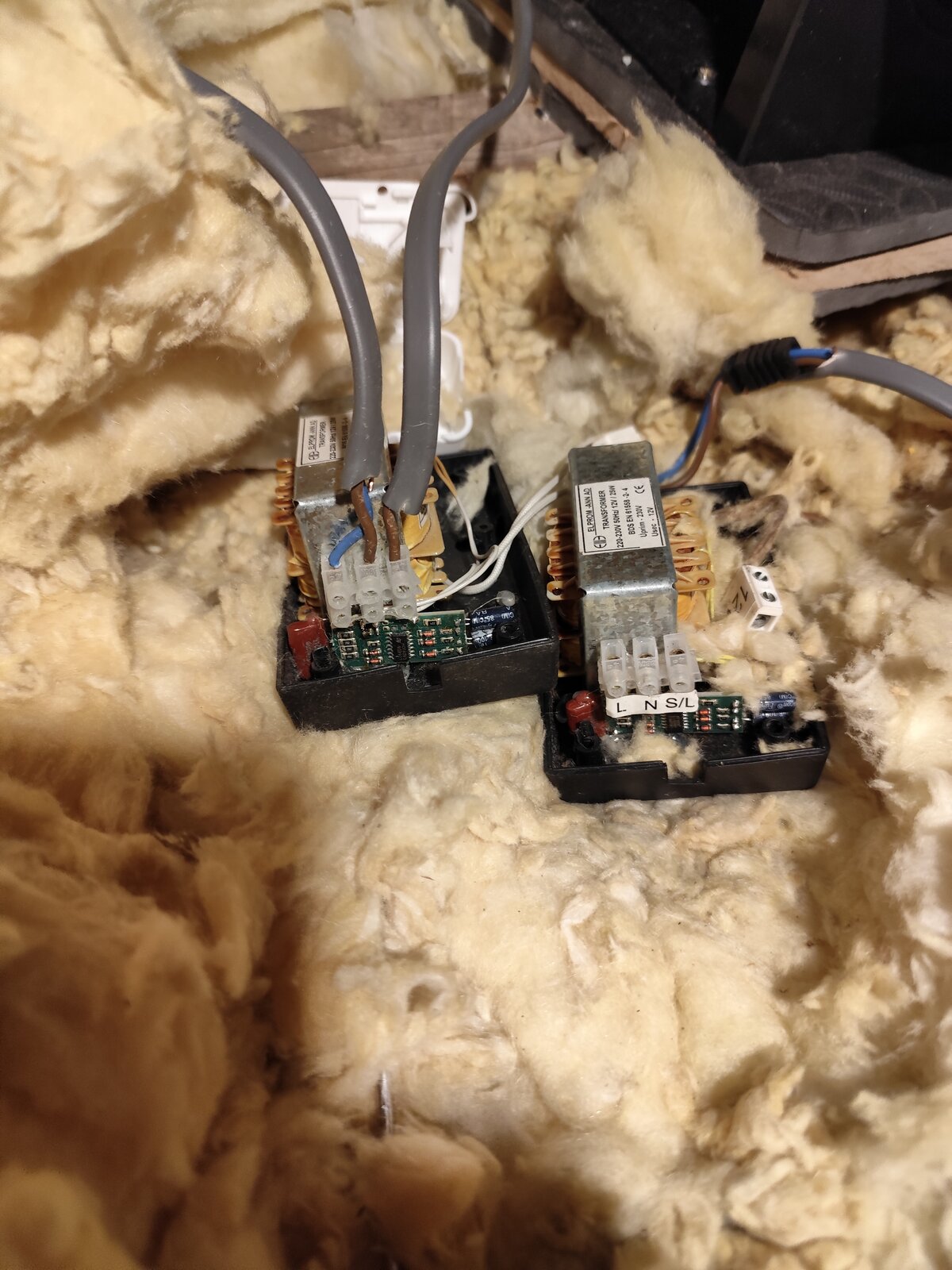

Swapping an old fan that had a transformer, removed transformer and there were SL N and L wires
Put them into new fan and the fan just gets constant live and stays on even with light switched off. Tried it with 2 new fans and both fans same issue, different models.
And yes, with the old fan it turned off after 10 mins overrun.
I swapped the wires over and it's the same issue...

Did you take any photos of the old fans wiring and your new fans wiring?
If you put your old fan back the way it was, does it work correctly?
upload pics of the rose switch and fan wiring with each end identified

When i turn light switch on, nothing, but when i turn it back off again then it kicks in.

Now the old doesn't work. The cable in sl is from light even swapped around it still works continuously
I know that electricity doesn't know what colour wires it is flowing through, but why have you connected a brown to N, and a blue to L ?
