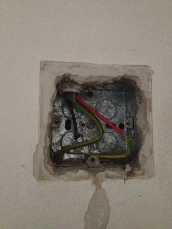

Hello. I have removed an extractor fan and no longer need the switch. I was going to put a faceplate on but was wondering if these wires are safe before I put it on or do I need to get an electrician out to do something?

The best plan would be to pull the cable completely out of the wall (from above) and totally disconnect it.
Otherwise, you need to terminate the ends of those wires in a bit of insulated terminal block (aka choc block) and put a blanking plate over the box.
