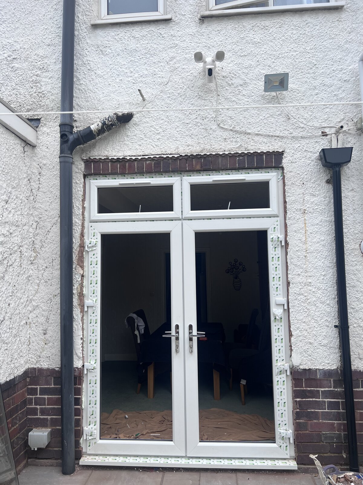

Just had a door replaced and the brick soldier course has slipped. Mortar between the bricks has gone in the middle .
The internal skin (solid 9” wall) is fine as there’s an old timber beam.
What are my options to rectify? I’d like to keep the soldier if possible. Also what sort of costs am I looking at.

If the previous door was timber there possibly was no lintel. The window/door installer should have identified this prior to doing the install and this is part of Building Regulations & FENSA requirements.
An steel angle lintel and patch work may be looking in the order of £1000 all said and done.
Your options are to fit a proper steel lintel - IG L10. Not a rusty bit of angle iron!
Looks like the wall above has already dropped previously.

Much appreciated. I’ll get some quotes. At least I know what I’m looking for. Window fitter suggested concrete lintel which wasn’t going to happen as it would look terrible
Yes quite possibly when the old window was installed. Wouldn’t be keen on non galvanised steel as it would just rust.
I’ll get some quotes to install a proper lintel. Thanks woody
Concrete lintel and render over it all nice and new as all the render needs addressing in the local area anyway? What if the bricks get damaged when removing and the new soldier course will have to be sourced from newer bricks may not get a good match ?
Yes the render will need to be sorted as well. The bricks should just pop out, but luckily I have 5-10 matching spares if needed for the header.

It was propped up. Definitely moved as can see gap in the top of tile detail and the brick now touches the new frame in the middle where there was a gap
